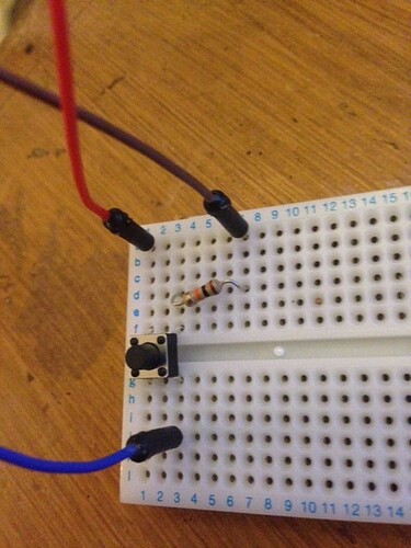

Back again and need some help if anyone would be so kind,
(As previously mentioned, My electronics and coding knowledge are virtually zilch)
WHERE I’M AT:
I have a strip of 124 LEDS on pin 2 (this goes to the LED strip data wire)
I have a momentary switch on pin 4 which either reads HIGH or LOW.
(Pretty sure when it is held down it reads HIGH)
and I have two LED PATTERNS/states…
FIRST PATTERN: about 20 red leds in a row chasing along the strip indefinetly.
SECOND PATTERN: Single white LED chasing along the strip indefinetly.
when turned on, the led strip is in its first pattern (good), and when i HOLD down the button is stays in its second pattern. (good)
WHAT I NEED HELP WITH:
I need the first state to light all the leds up white by default (255,255,255) (This is the resting state) without having to manually write every single led. (Anyone know a nice way of setting all the leds to the same value in a short piece of code?)
then when the button is pushed i need the second pattern to run for a while before it goes back to its first state automatically. the button isn’t intended to be held down. its simply supposed to be hit… the leds chase for a while (lets say 10 seconds) then the leds go back to being white.
Please if anyone can help me, I would be eternally grateful. I’ve been trying to get it to work all day… It’s s giving me a headache and i’m supposed to have it finished to show my superiors tomorrow.
I’m gonna need to be walked through this like a toddler guys, as i’m simply not understanding the code very well.
Much appreciate, KVR, code below.

kainevfx:
  for (int i=0;i<NUM_LEDS;i++)  leds[i]=CRGB(255,255,255);
  FastLED.show();
kainevfx:
I don’t see how you want to control three states:
  • all LEDs set to white
  • Pattern-1
  • Pattern-2
    including pattern-fallback actions by time with just one button. I didn’t understand from your writing how you want to manage that.
    What’s the button press logic for doing that?
Hey Jurs!
Thanks for helping again, your a saint.
Not 3 patterns just two states.
Initial state, all white leds. upon button being pressed... second state begins which is a red chaser.. return to first state after 10 secs.
and on and on like that... so essentially i want a continuously fully lit strip of white.. everytime i hit the button i want it to chase red for ten seconds before returning to white.
that make sense? I'm sure its simple to do but i think i'm really overcomplicating it.
kainevfx: Not 3 patterns just two states.

Blue goes to pin 2 on the arduino
Brown is Gnd
Red is of course power.
in the attached images. also shows the resistor i’m using… PS: i’m only using that resistor because i’ve tried copying a schematic for a simple button, i dont entirelly understand why i’m using it or its purpose.
Although i do vaguely realize its keeping the reading LOW unless the button is pressed.
