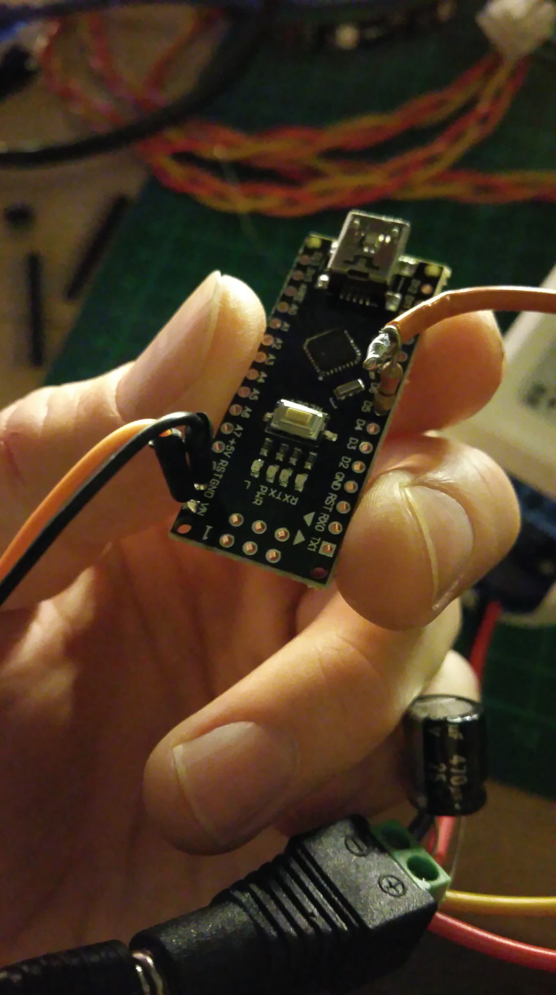

I've got a WS2811 LED strip (the one with 3 LEDs per chip) and am driving it with an arduino nano clone. I have downloaded the FastLED library and have uploaded the test program. The strip and the nano is being powered by a 12V 6.3A PSU. I have a 330ohm resistor between the data line and pin 5 and a 470uF capacitor between the GND and 12V. The 12V from the PSU drives the 12V on the strip and the Vin on the nano, likewise the GND goes to GND on the strip and nano.

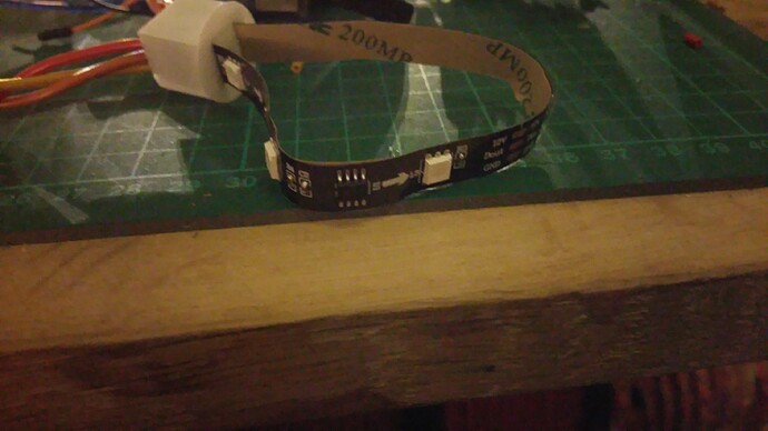

If you're wondering what the white thing is, it's a 3D printed clampy thing that protects the solder joints and clamps the strip and wire in place to avoid it breaking. I've tried powering a normal strip straight out the bag to the same avail so I don't think it's the culprit.

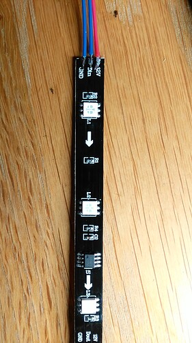

Are you sure this is a ws2811 strip? Can you read any labelling on the chips?
There appear to be 6 LEDs on the strip shown in your pictures, so two chips? The NUM_LEDS in your sketch should be set to 2, not 10. Worth a try, but not sure if it will fix anything.
Sorry, I guess that picture wasn't very clear. In that "loop" I have 20cm of strip: i.e. 6LEDs and 2chips. There are 5 of these chained up at the moment, so 10 chips total.
(changing the number of LEDs makes no difference, all LEDs still light)
The chip reads: GS1903 C1753

I've also got a Novatech 500W ATX Power Supply that I use for my 3D Printer. I guess I could try running it off one of the 12V lines coming out of that. If I'm not mistaken the power coming of that should be pretty clean right?

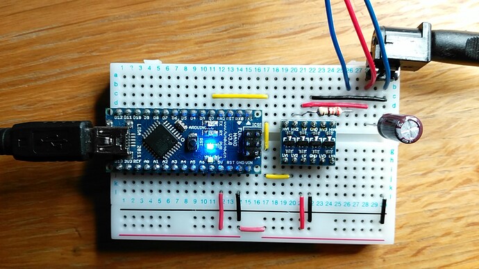

This is how I did it:
I used 1 channel of a 4 channel logic level converter module. You can buy these very cheaply on eBay etc.
LV --> 5V
GND --> Arduino GND
LV2 --> D2 on Nano (or any pin you like)
HV --> 12V
GND --> GND (surprisingly, it seems to be important that both GND pins on these modules are connected UPDATE: this was because I stupidly missed connection on my breadboard circuit!)
HV2 --> 330R --> Strip data input

I don't think that is the OP's problem. His strip is marked clearly:

Why does dropping the voltage down to 3V make it happy though? (I assume that's what it's doing)
