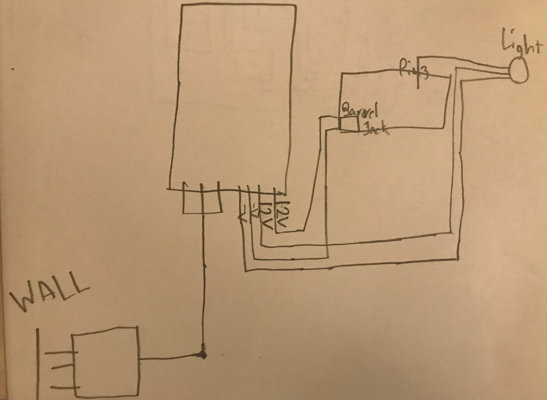

Thank you to everyone for replying! I drew the schematic out on paper. This is what believe I need to do. If I missed anything, please tell me!

Looking good. clear schematic.
So 3 things i see
  • The Arduino and the strip need to schare common GND. That means that either the -V on the transformer has to be connected internally, and you can confirm that with a multimeter, or you can just connect them. If they arre already connected and you connect them, there is no harm of course. To make the schematic more clear, you should connect the -V lines in it.
  • On the data line (pin 3) there should be a resistor in series between the pin and the strip. For 5v systems 470R is specified, but 330R will also be ok. It will work without it most of the time, but it is better to put one.
  • The 470uF capacitor (or 1000uF basically a big one) between 12v and GND at the beginning of the strip. Again it will probably work without it, but you may have issues if you don't have one there (as stated before it has never really been an issue for me)

Where are you going to put the Arduino ? Again the same issue of course, though a box for that is not to hard to come by, and there are big advantages to having it closer to the led string.
So regardless you will need cable of a fairly decent cable if you are going to run it outside, it should be insulated. Depending a little on the distance it will need to be fairly thick as well. As stated before voltagedrop is an X amount per meter, and the thicker the cable, the less the drop. I tend to use speaker cable because it is fairly cheap and readily available in thick gauges, but something double insulated like mains power lead could also be ok and may even be better. The distance it covers is relevant, and also the amount of leds is relevant. Standard 3 strand tri-colored cable comes in AWG 22, which in many cases is going to be to thin.
Now about the data cable. Ideally this is really short. The main issue with a high speed data signal (800 KHz is pretty quick) transfer is that all cables have. This image shows what happens to a data signal as a result of that.
Calculating capacitance is complex, but it is simple to understand. Capacitance is a 'physics effect' that takes place at the surface of metal when it is electrically charged. The cable starts to act like a (small) capacitor, and basically, the more surface, the more capacitance. So the longer the cable, the more capacitance, and also the thicker the cable, the more capacitance, and here it is the exact opposite of voltagedrop.
There are ways to counteract capacitance, but if you can manage to put your arduino close to the led string, you don't have to. With AWG 22 you can probably cover about 5 meters (and maybe more) And with a thinner cable even more, but a thin cable is fragile. And now the current limiting resistor on the data line me also be counter productive, so these are the considerations.
It may be practical to have the arduino indoor, so you don't need to waterproof it, and it is easy to upload a new sketch, but have it close to the string simplifies things as well. Choices....
About the waterproofing. The string itself is waterproof enough (probably IP67 or something), but the connecting plugs that come with it aren't. You can solder the whole thing together and use shrink-tube for isolation (and tape, found out where the cat took the roll of tape... ) but that might not be so practical when you install, put up, take down and stuff. Mind you most defects in installation are caused by the repeated putting up and taking down of deco regardless, but if it is all one thing that doesn't help.
There are (near) waterproof 3-pin plugs available and it is definitely handy to be able to easily connect extra power in between strings (of 50 leds) . You can also just try and make the non-waterproof plugs more water-resistant by using cling-wrap. I was hesitant to with this advice, but in truth. It is a 12v (or 5v) DC system, and water itself does not conduct much DC current (AC is a different matter !!). It is the ions in the water that does. In practice moisture does not cause much problems, but if you hang it in the rain for extended period of time, corrosion may cause issues. The more waterproof the better !! (of course, but also more expensive)
So as a final suggestion. If you use 12v string, you could power the string from the halfway point (or between say the first 50 leds and the last 100 leds, you don't have to cut one of the strings), reducing the voltage-drop to the last led. And.. power the arduino from the starting point of the first string. It will consume about the same amount of power as 1 Pixel at full brightness and that the voltage is a little less than 12v on the barrel jack is really not a problem (in fact it is better to power it with 9v than with 12v. 7v is the minimum requirement)
Of course the Arduino really should be housed near waterproof.
