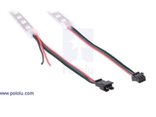

For Clarification i found this
Now it's not always a hard and fast rule
but look at these 2 connectors, now USUALLY on a roll you get only 1 connector, but..
if you get 2 it usually works like this
The connector on THE LEFT....
especially since you have the extra black and red for additional power, this is the front side connector (the Male) If you connect to this side it'll work
The Female connector on THE RIGHT is the one that was used,
this is at the end of the strip
the trap is... it's easier to crack out a few jumper wires and pop the pins into this one
and that's why it happens

In summary, take special care to insure you connect the LED strip supply voltage to the correct connector pins. Also, be careful to observe the correct logic signal direction, denoted by the arrow on the strip.
It’s probably worth mentioning that you can connect power to either end of the strip and even at intermediate points in the strip as long as you observe the proper polarity. Data, on the other hand, can only be connected at the beginning of the chain. The arrows will give you a clue as to where the beginning is.

The manufacturer put those arrows on the strip to indicate the direction of signal(data)flow. The manufacturer put 5V & GND on the strip to indicate how to hook up power. The manufacturer didnt see any point in even indicating which way current flows. It's irrelevant to the hookup procedure.
OP is correct to power their strip from whichever end they prefer. Their mistake was connecting the data signal to the wrong end because they overlooked the arrows.
This is true, and can be verified by putting SIG in the right end (PIX lights) and again in the wrong end (no PIX light).
This is true and can be verified by a continuity test. The GND pad at PIX#0 buzzes to the GND pad at PIX#N, and the same with 5v pad (continuity). This allows "power injection" at any point to keep the lights from sagging.
