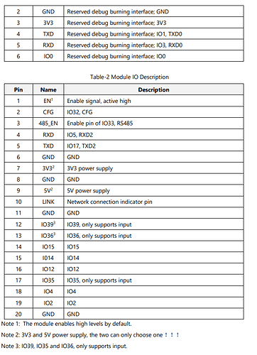

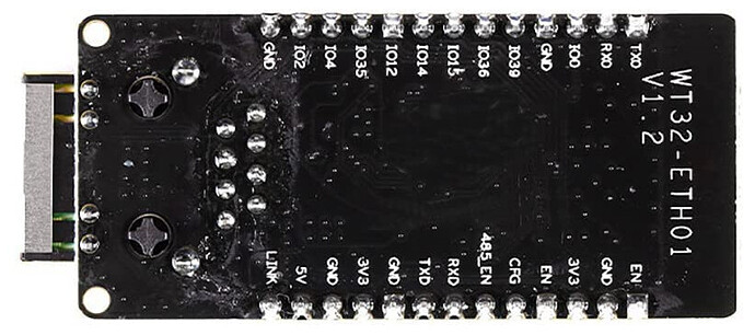

The pin I have chooses to use are
#define GREENLED 19 // POWER LED
#define YELLOWLED 18 // SCALE LED
#define BLUELED 16 // ETHERNET LED
According to WT32-ETH01 sheets those pin are not in used at all:
BTW: I didn't even connect the LED to the esp.

Does anyone have any idea why the pinMode function breaks it?
