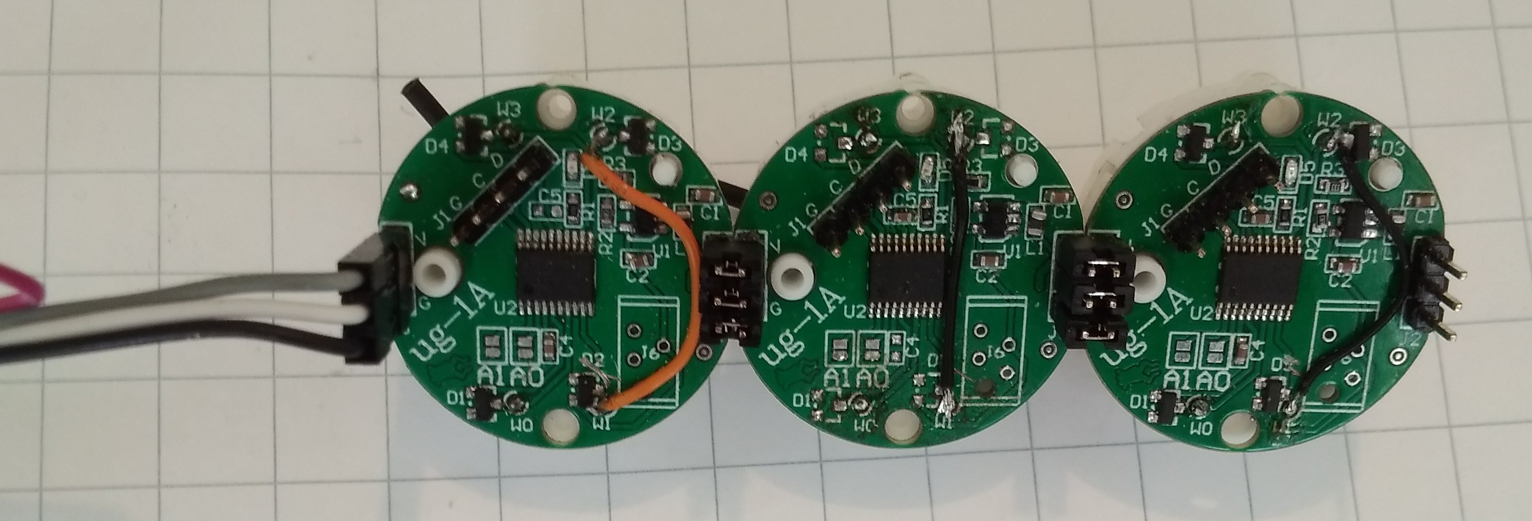

Hi, here's my take on the gauge stepper driver.
Each gauge has its own microcontroller/driver, daisy chained to up to 15. Controlled by just one Arduino's serial TX plus 0/5V power, each stepper is individually addressable. An ultra-simple protocol directs pointer movement to any position from 0 to 944. Ramps up and down, works like a charm.
Shown are three units daisy-chained with jumpers, normally the chain would be made with a 3-conductor strip. Forgive the blue wire...

The micro is a STM32F030 in a TSSOP-20 package. Each of the four coil ends is driven by two output pins in parallel, push-pull. This gives abundant driving current. The usual two Back-EMF suppressing diodes are BAV199 in a dual package.
The daisy-chained supply can be anywhere from 3.7 to 16V, but the serial line must be limited to 3.6V which is the micro operating voltage. Incidentally, there's no need for a 5V supply: I found that the stepper works reliably from 2.3V up, so 3.6V is more than enough.

The stepper is driven in “partial steps”, each advancing the pointer by 1/3 degree. The full pointer scale of 315 deg thus resolves to 945 “partial steps” Pointer positions are consequently numbered from 0 to 944. A movement command specifies the address of the target gauge in the daisy chain, an ‘M’ for “Move”, and the target position in decimal:
As an example, the command “3M477” directs the third gauge down the daisy chain to move its pointer to exactly mid-scale. Currently the only other available command is “Z” as in “2Z” which directs the second gauge pointer to the minimum (zero) physical stop at slow speed. This is typically used at power-up.
Addressing pointer positions uniformly from 0 to 944 means that a gauge has no inherent “knowledge” about the unit it is supposed to display. Together with the simple addressing scheme, this brings a few advantages: driver boards are all the same and interchangeable; Firmware need not be customized for each gauge. On the other hand, the controlling CPU (say an Arduino) must be aware of each gauge’s dial in terms of unit, scale and min/max values, and translate a measurement to a 0..944 pointer position. Take as example a temperature gauge in degC from -40 to +120 ^C. Here is a possible function to drive the gauge.
