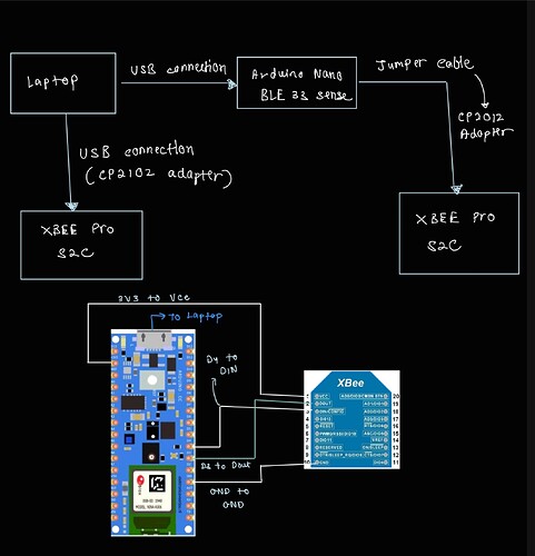

What we really need is a schematic diagram showing what the OP did, since that is completely unclear. The XBEE adapter linked is for a USB connection, not for an Arduino connection.
@rayford03 please post a photo of a complete, hand drawn (pencil and paper) wiring diagram of your entire setup, with modules, pins and connections clearly labeled.

This is the setup that I am using. Also I am using the same adapters for USB connection and for connection to Arduino, the adapter has pins and I used jumper cables to power it from Arduino by connecting them in the same fashion as in the diagram. Using the same connections, and just replacing Nano BLE 33 Sense with Uno, the whole setup worked perfectly.
@mikb55 I tried researching about the built in voltage regulator on the XBEE Adaptor that the product page talked about. The IC mentions its name as AMS1117 3.3 H103MC. I tried giving 5V through the voltage regulator to the XBEE, but the problem still remains exactly as it was before, it received but didn't transmit.
Sorry, I can't make any sense out of your drawing, and can't imagine what "Jumper cable CP2102 adapter" might be doing between an Arduino and an XBEE.

Can you explain what exactly is still unclear to you? The Xbee is seated on the adapter just like any other normal Xbee shield. This adapter provides the convenience to use jumper cables to make an electrical contact between Arduino and Xbee, and not by just using USB connection, and it does so by extending the 20 pins of Xbee out of the adapter. These are the same jumper cables that we use for connecting different components on a breadboard. I honestly don't know how to elaborate more.
