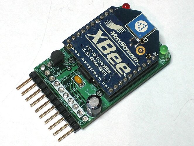

I'm connecting the xbee's useing a Xbee explorer (XBee Adapter kit [v1.1] : ID 126 : $10.00 : Adafruit Industries, Unique & fun DIY electronics and kits)

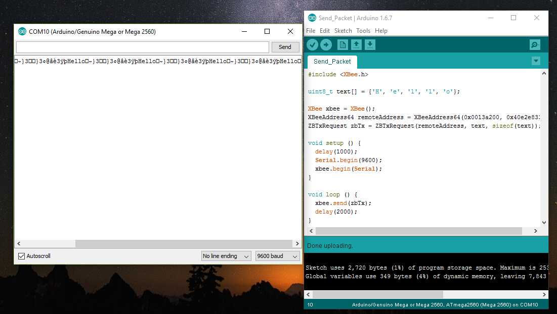

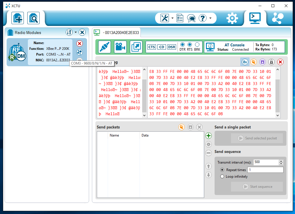

So firmware are the same on XCTU, i am unable you see anything when i write "+++" in serial, but what i have found is using the xbee library i am able you send to the other xbee but it the data is messed up. Here is the code im using

Im also attaching 2 images and putting both link here too so you can view i picture in full size.
What is the baudrate of your xbee module? Check it with your XCTU. If you don't see OK after typing in +++, you are not using transparent mode, or you're using the wrong baudrate.
