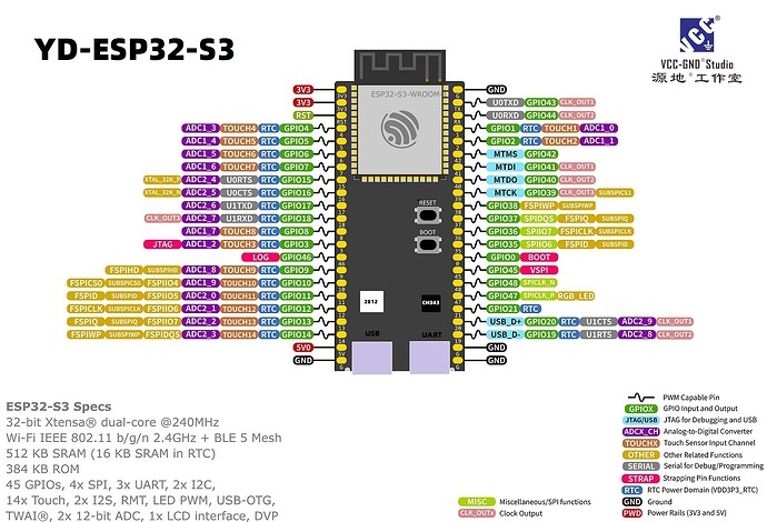

There was no documentation or link in my bought ESP32. After long search(Images) I found out, it is this one:(I see a "YD-ESP32" label on the back, which seems to confirm it)
I am desperately trying to make a Display work, but NOTHING. I carefully used that chart, to find my GPIOS for MISO, MOSI, CLCK, and so on. (SPI display)
example: Setup.h (TFT_eSPI)
MISO GPIO 11.
Regarding that chart, GPIO11 is actually PIN 10.
= MISO gets get connected to PIN 10.(GPIO11)
This was the way I was using it.
(But I am TOTALLY stuck for 20 hours!!!, to make my TFT work. ILI9488.(3.5inch))
Then I REMEMBERED:
When using the blink example 8 days ago, I actually used the REAL PIN numbers on my board. So going back to my example:
#include <Arduino.h>
#define LED_PIN 11 // GPIO 11?
pinMode(LED_PIN, OUTPUT);
digitalWrite(LED_PIN, HIGH);
delay(100);
digitalWrite(LED_PIN, LOW);
delay(50);
So regarding my chart, GPIO 11 is actually PIN 10.
But my LED blinks on PIN 11!! not 10
or to make it less confusing:
when using 18-8-3 for 3 leds inside my code, that ARE actually the real pins blinking, NOT the ones from the chart!!
No Wonder nothing works, I need to get this straight, before trying with the display again.(Many setup combos possible)
So where on my BOARD is GPIO 11? lol...that question sounds really stupid, having all the documentation now..lol....but here I am.
Is the pinMode maybe using physical pin labels, and the other stuff like SPI not?
Maybe SPI is different?
Or the digitalWrite?
What's going on?
