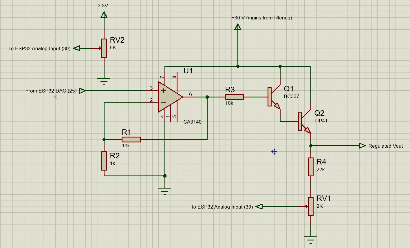

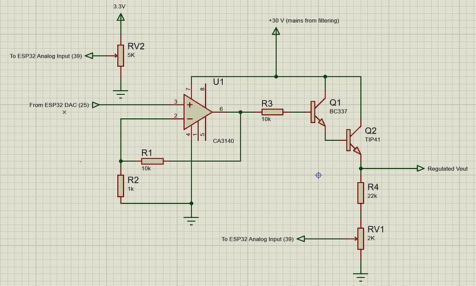

I gave it a try, and that´s what I came up with so far:
The schematic and a picture of the mess are attached.

First impressions: Voltage range goes from 0.4 to 25V. I tested it only with very low current, 400mA max. And it worked really well! Voltage output was very stable, and even fast changes on the load didn´t cause any fluctuations on the output.
Punch list:
  • test with actual current (up to 3 amps) and another (bigger) transistor on the output
  • implement current monitoring and code for current limiting (maybe constant current as well)
  • implement display and maybe rotary encoder
ESP32 was running at 160MHz, so it can still be faster if necessary.

i would like to see the output on a scope. There’s got to be some lag and switching. What’s the load and did you have capacitors on the output?
The circuit clearly shows no feedback other than digital.
Thanks for sharing, would love to see scope and further testing.
How fast is the error correction? There should be some integration in the opamp and perhaps the transistors.
Another concern is the 8 bit DAC that’s only 256 steps, that’s not giving you any quantizing or oscillation?
OPs images.
RV2 goes to input 34, just a typo I would assume, nice clean diagram. :slight_smile: :slight_smile:
Input 34 is the OUTPUT VOLTAGE SETPOINT
Input 39 is the OUTPUT VOLTAGE FEEDBACK

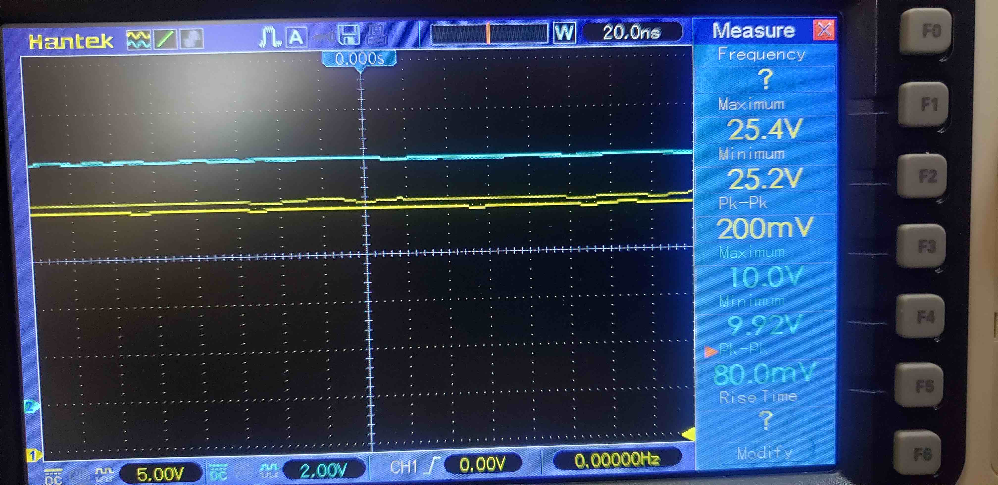

Wolframore, I did some more testing today, and even got you some scope images. I'll post pictures of the screen here, since I don't know a way of saving a bitmap or something like that. Suggestions are welcome!
There's no noticeable lag, response is really fast. Of course, as more features are implemented, more cpu cycles will be necessary and response will slow down, let's see if it will be an issue.
There's no noticeable quantization either, and I think that is kind of expected, since the control signal and output are supposed to be constant over time.
What's new:
I added a third transistor on a heatsink, a 2SD1047, to handle higher current. Obviously also moved one end of the voltage divider to the emitter of this new transistor.
Here is the scope picture of the system with no load:
Input voltage is 32.4V and output set to ~10V (9.8V)
Here the picture with a 1 amp load
Input voltage dropped a lot, down to 25.4V; output voltage raised a little, to 10.0V
Here the picture with a 2 amp load
Input voltage dropped severely, this is the limit of my transformer. Output raised a little more, to 10.3V, this is weird ...
In both 1 and 2 amp loads input ripple was between 200 and 400 mV, there was only a 2200uF filter. Although, ripple on the output was steady at 80mV
Esp32 was being powered by computer USB port, and grounds were connected.
About the voltage raise: I could notice that there was a little raise on the voltage set trimpot, which means that the 3.3 line has raised a little bit with higher currents. I still have to figure this out, but it doesn't seem too complicated to solve. Any ideas?

thanks that's pretty cool... could you zoom in to the output... I like to see it working... any way of putting active load on it?
