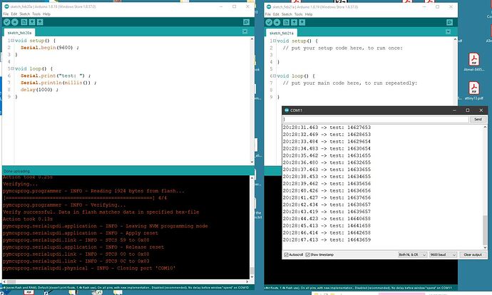

Anyway, to visualise what it can do, see this simple screen shot showing two active comms channels, one for the UPDI interface and one for the USB/UART interface. IDE 1.x is used here for simpler simultaneous handling of 2 instance of the serial monitor. The target device is, incidentally, an ATtiny 1614:

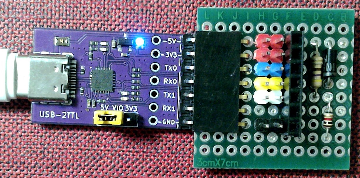

Hardware build and schematic
Here is some of the detail about the device and what it looks like. It consists of a module CH342 USB-2TTL, stocked by a number of AliExpress retailers (I got mine from YourCee https://www.aliexpress.com/item/1005008001334082.html) and a small addon circuit consisting of two resistors and a diode together with a number of mainly optional connectors. Serial channel 0 (TX0/RX0) is dedicated to normal serial activities. Serial channel 1 (TX1/RX1) is dedicated to the role of UPDI programmer. Note, however, that a hardware modification, described later, has to be applied to the CH342 module to make it function as a UPDI interface. That is, the channel 1 leds have to be disabled and without this it simply will not work.
The complete schematic of the CH342 USB-2TTL module is included for reference together with that of the add-on circuit. Since I don't have a method of measuring the value of capacitors in circuit, I've left the values blank. The module design uses a common but crude method of handling the leds to signal serial activity on the RX and TX pins which affects the signal presented to the target UPDI port. In practical terms the solution is to disable the leds. The recommended way is to cut the PCB track identified in the picture. Other methods are removing the leds (or their series resistors). Any complete board (re-) design could use a transistor or similar component

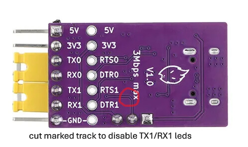

to less invasively control the leds and without damaging the signal, the state of which, the leds are supposed to indicate. Note. Before you even start, verify the existing functionality of the CH342 USB-2TTL module so see the troubleshooting guide below for ideas on how to test it.
Schematic for both the CH342 USB-TTL module and the prototype board:
CH342F_V0_01.pdf (170.0 KB)
CH342 USB-2TTL module front with components labelled to match the schematic:
CH342 USB-2TTL module rear showing track to cut (red circle)
Prototype board front:
Prototype board rear (bus wires highlighted)
Performance tests
  • only tested with the MegaTinyCore [ref 2 below] and Arduino IDE 1.8.19 / Windows 10
  • The device appears to retain the same allocated com ports across sessions. I tried alternatively with the two devices I purchased and this behaviour was consistent.
  • Seems to work at 230400 baud (and of course 57600 baud) for UPDI at 5v.
  • 460800 baud worked with the "delay" option and failed, producing a screen load of error messages, without the delay. Again at 5v.
  • Attempts to use 921600 baud rates showed these were not actually attainable and the operation quietly fell back to 115200 baud proceeding to a successful result, albeit at a lower speed.

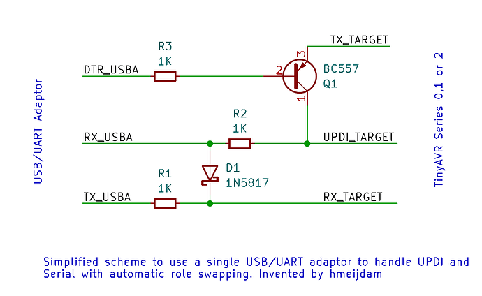

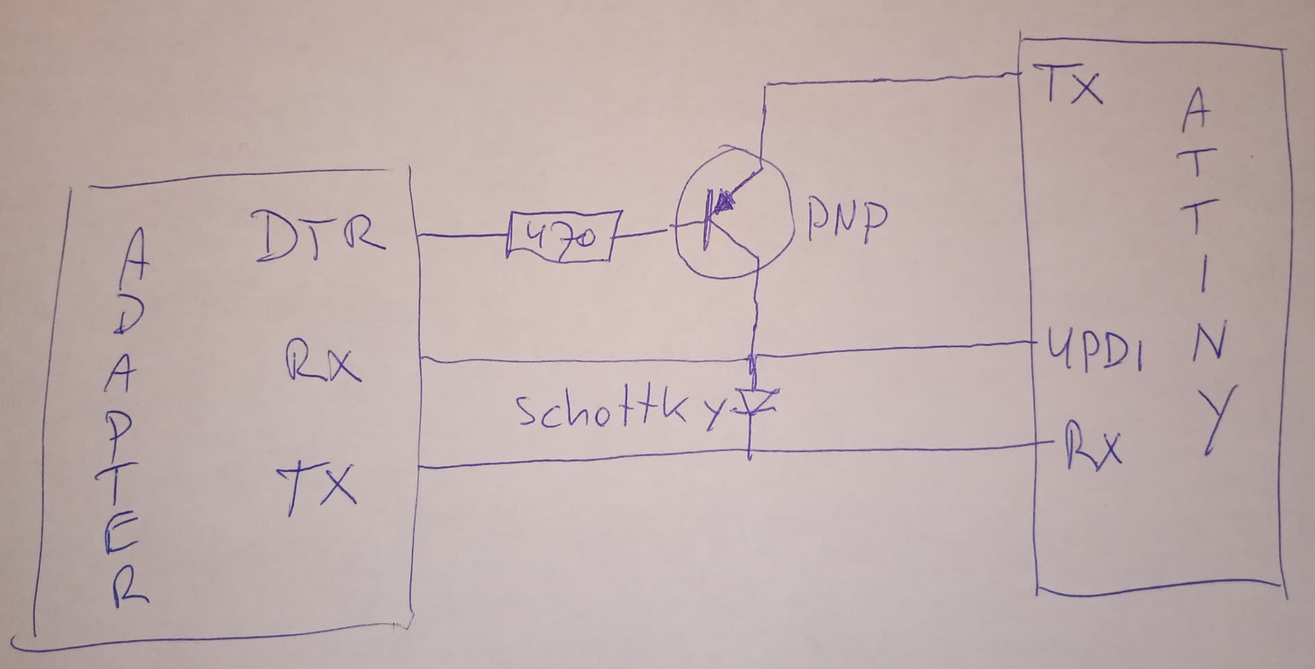

Your programmer actually made me think if it is possible to upload via UPDI and print with the same Arduino IDE window. Like we are used to when having a bootloader on e.g. a Arduino Uno.
You can, and it's simple.
After some experimenting on my breadboard I let the DTR pin from the serial adapter disconnect the Attiny TX pin from UPDI. After programming is done TX reconnects and you can resume printing.
Here is the schematic.
Instead of a PNP transistor you could use a P-channel mosfet, bus driver, logic gate or whatever. As long as you can disconnect the TX pin when sensing a HIGH level on the DTR pin.

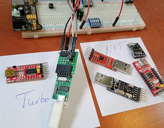

That's done now and I tested all my serial adapters that break out the DTR pin (the adapters you can use for a Arduino Promini). Two of them work on all upload speeds and 4 of them don't work at all.
The red one on the left is the FTDI adapter with the fake FTDI chip that pops up in every search when you look for "FT232RL adapter".
The ones that don't work, probably need their leds desoldered or some resistor removed, but I did not look at that any further. For me it works easy.
You have an impressive collection of adapters there with quite a variety of USB connectors. I'll be retiring my non USB-C adapters to minimise the cable salad I maintain as these are so cheap now.
Is that series of tests you've just completed with a Schottky diode or a normal small silicon signal type ?
I guess that some of those adapters would never work with a normal silicon diode.
Also did you look carefully through the log output of the Turbo attempt to check it had not fallen back (quietly) to 11500 baud ?
The maximum I can get is 460800 baud at 5v and that only if I select the option with the write delay. I even shorted out the additional resistors but it made no difference.
Turbo terminates OK for me but only after falling back to 115200.

Yours looks OK, or at least you don't appear to have had a specific warning.
This is what I get with Turbo:
pymcuprog.serialupdi.physical - INFO - Switching to '921600' baud
pymcuprog.serialupdi.application - WARNING - Cannot read SIB, hard reset...
pymcuprog.serialupdi.physical - INFO - Sending double break
pymcuprog.serialupdi.physical - INFO - Double-break sent. Retrying.
pymcuprog.serialupdi.physical - INFO - Opening port 'COM10' at '115200' baud
But then it goes on to a successful termination.
Thanks for explaining. Then something else than baudrate must be causing the green adapter to complete writing in 0.24s vs the red one that needs 10 times longer with 2.04s.
Here: GitHub - SpenceKonde/megaTinyCore: Arduino core for the tinyAVR 0/1/2-series - Ones's digit 2,4,5,7 (pincount, 8,14,20,24), tens digit 0, 1, or 2 (featureset), preceded by flash in kb. Library maintainers: porting help available! under the title UPDI programming, there is a mention of "long latencies" with those FTDI type adapters. Maybe that is the explanation.
It was.
Setting that from 16 to 1 changed the upload time to 0.17s on the FTDI
I have been following the discussion with interest. I have a question about the DTR-transistor-controlled circuit, please.
Does this work seamlessly with standard Arduino IDE + megaTinyCore and DXCore, or does it require custom avrdude command line flags or modifications to control DTR/RTS behavior?
Is there a final recommended schematic? Did you conclude that any USB-to-serial adapter that uses LEDs for RX and TX that are connected to the RX and TX pins requires those LEDs to be disconnected?
This particular trick was the invention of @hmeijdam and thus would be the best person to answer it. However, what I can say is the following.

In many but not all cases leds, which are driven directly by the serial pins, have to be removed. Blue leds, if my memory is correct here, are generally worse than red leds. Some experimentation with the upload speed options under tools -> programmer, in the IDE, may be required since lower speeds are more tolerant.

For the 4 adapters (out of 6) that would not work at all, I never made effort to investigate what caused that. The 2 that work fine, still have their leds. Maybe they have higher value series resistors for their leds, making the leds less damaging for the signal. But this is pure speculation from my side. The right answer would be “I don’t know”.
