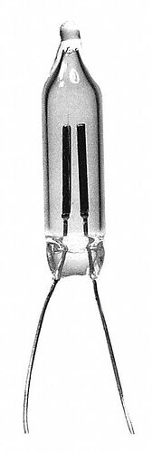

You can detect voltage with very low power consumption, but you still need some power to drive your circuit and/or to drive an LED. For example, a digital multimeter might have in input impedance of 10-100 megohms, but it's powered by a battery.
How much power does one of those little neon lamps require? It can't very significant.
The neon lamps use ~0,35W.
From my point of view thats allot. In times where we change to LEDs in our house (incandescent light bulbs are already
banned here in Europe) and with the electricity price....
10 of this neon lamps running 24x365 is near $10 a year.
So if you look at all the stuff around the house, every watt counts.
Also the neon lamps will not work on the dimmers.
Must be walloper size neons....most i've seen draw around 400 microAmp 90 volt
58mW
Interesting to see a circuit that can draw less.
I imagine that the 58 mW rating is the maximum power dissipation.
I can light up those neon bulbs with static electricity from a hair comb, so a few microwatts ought to suffice for enough light to indicate that voltage (greater than about 90 V) is applied.
0.6mA at 90V is about 58mW, so I think that is the rated power under normal use. Bright enough to see in a panel indicator, with a sensitive detector you could certainly reduce the drive.
Ah ok, i looked and found some 230V 0.5 mA neons.
I was looking ad the ones we have here for the stwitches in our house.
But they are 20 years old and orange. I thought neons are always orange.
It looks like orange neons draw more power: http://www.conrad.de/ce/de/product/725013/Farbige-Glimmlampe-230-V-025-W-14-mA-Orange-Barthelme-Inhalt-1-St
But:
  1. They lose brightness over years.
  2. What happens with them behind a dimmer?
  1. What happens with them behind a dimmer?
Most dimmers just cut out part of the AC cycle, so that the ON time is shorter. A neon lamp will still light "behind" such a dimmer.
Until the part left over doesn't reach a high enough peak to turn on the neon. But that'll be getting rather dim.
As you can see in the datasheet from my dimmers they can do everything (leading phase angle / trailing phase angle).

Glow lamp current up to 5mA starting at 110V
I really don't want to kill such a expensive dimmer and need to be sure it will work.
polymorph:
The neons on the back of camera flashes run at about 40 uA and are still bright enough to see.
jremington:
Assuming there is a neutral present.
