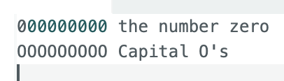

I’m not sure, but this seems to be a recent change. I’m seeing zeros with dots in the middle, in Code sections and in the basic editor. I assume this is to distinguish a zero from a capital "O". But it also makes the zero look like an "8", so on balance it's more confusing to me. Anyway, is there anything I can do on my end to change the font to something else that doesn't use dotted zeros? If not, would management consider making this change?
That is not what I see, this is what I see

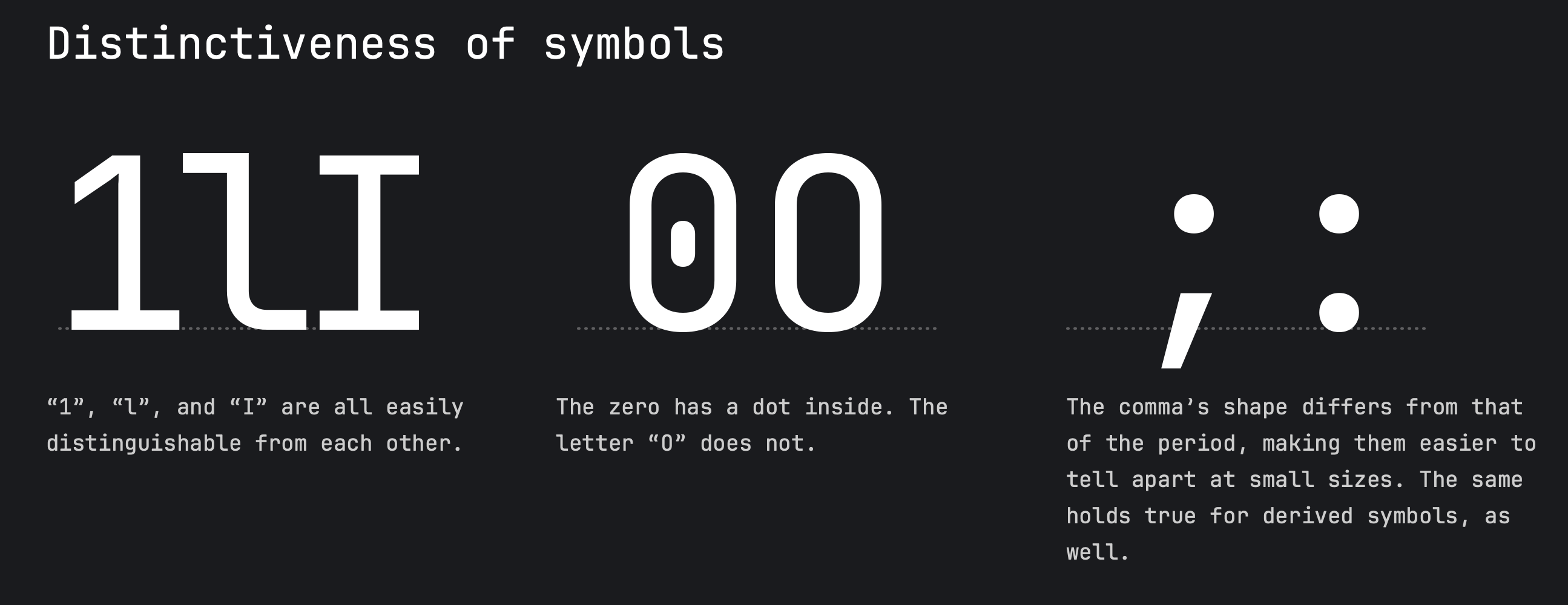

From Jetbrains site where they talk about the utility of their font:
First, settle on a monospaced font. I have neither Lucida Console nor Monaco on this Linux box, but there's Noto Mono. The OS should provide some kind of font viewer. (You might also try some wacky obvious font just to see if the substitution is working.)
