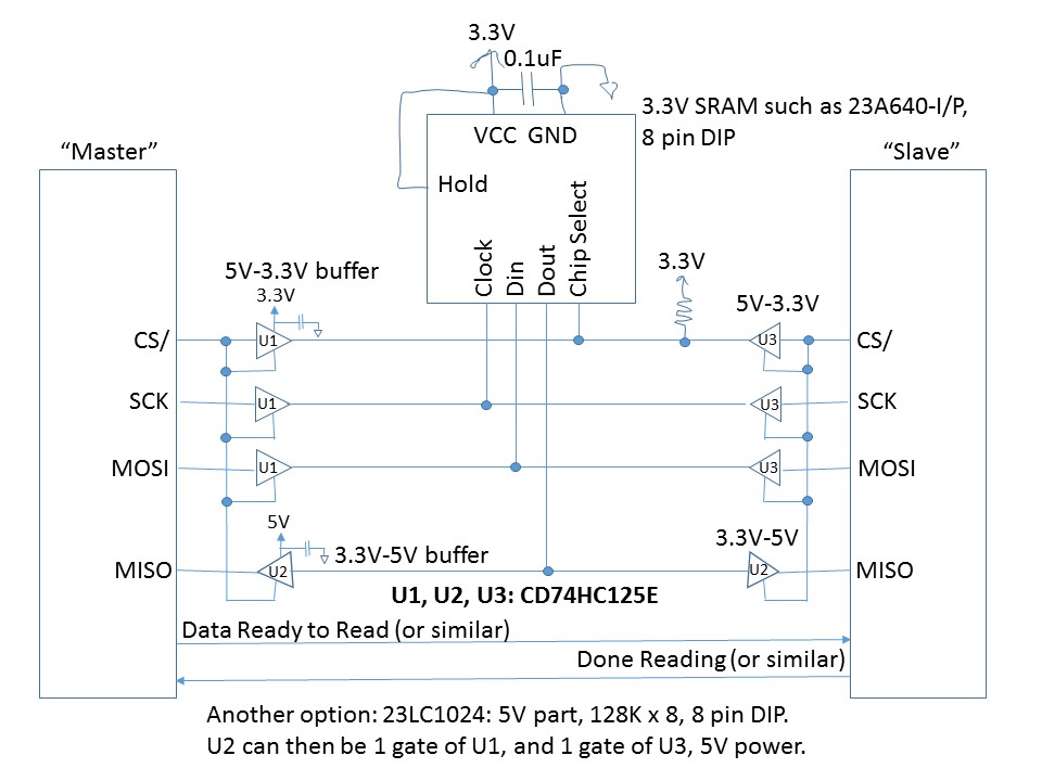

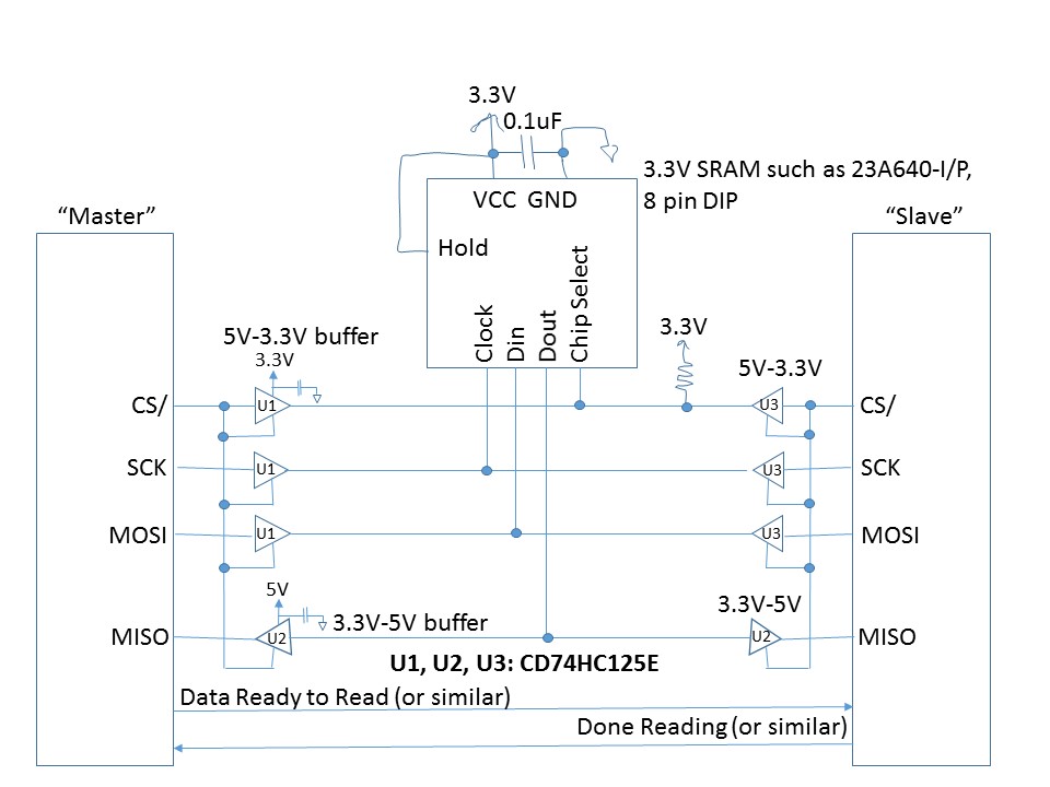

How about this - use a FIFO in between? Each device will access the FIFO as a master, writes on one side and reads on the other, with both sides then capable of 8 MHz transfers. Or a dual port SRAM. Or fake a dual port SRAM, with one side writing then flipping a control line to let the other side know to read the SRAM, with buffered control lines. I'll draw up a diagram.
http://www.digikey.com/product-search/en/integrated-circuits-ics/memory/2556980?k=sram&k=&pkeyword=sram&pv1291=862&FV=268001d%2Cfff40027%2Cfff80434%2C2380061&mnonly=0&newproducts=0&ColumnSort=0&page=1&stock=1&quantity=0&ptm=0&fid=0&pageSize=25
Same concept can be used with other memory types (SRAM, FRAM, EEPROM) and 5V devices also.
One- or two-line notification can be used. With one-line, each would read the line and only access the part when the line was not pulled low by the other side, with internal pullups enabled, or an external pullup.
I suppose that's one solution, although the overhead of writing to an SRAm with the additional SPI commands required would cripple overall data rates.
I did think of doing back to back shiftregisters, in a similair way, but no extra SPI commands need to be issued, but not sure how feasable that actually is (I suspect there comes a point where there's so much off board logic - it's perhaps better finding an alternative board for the job, like an STduino or some such)
I like the sram idea though, it could be used for better bulk transfering. The only issue with my application is that the master has to poll the slave (as only SPI pins are availble) to ask if we need to start a conversation, so there are syncronization issues there on how can access the ram, and when.
How large are the data transfers to be made? I would think that 8 MHz transfers on both sides would yield the best results, vs 8 MHz on one side and 1/2 that on the other. You could even go as big as 128K x 8, with all buffers powered from 5V, and just 2 buffer chips needed.

The problem lay in your last diagram, there are no extra pins to do the handshaking, I merely have the 4 SPI pins to work with.
I suspect two shift registers from the interface, one to write to and one to read from, and use the SS to determine when to write back, this of course means finding 16 data pins on the arduino, adding a bus expander or having back to back shift registers 2x2. Then things get complicated.
"As the SBC doesn't directly interface with the SPI layer, it writes to an address which starts the signalling, there's no way for the SBC know when things are done, it has to send data to address, wait a few clocks, then read back."
If you're doing it that way, then leave out the handshaking pins. Why would you need 16 data pins on the Arduino?
