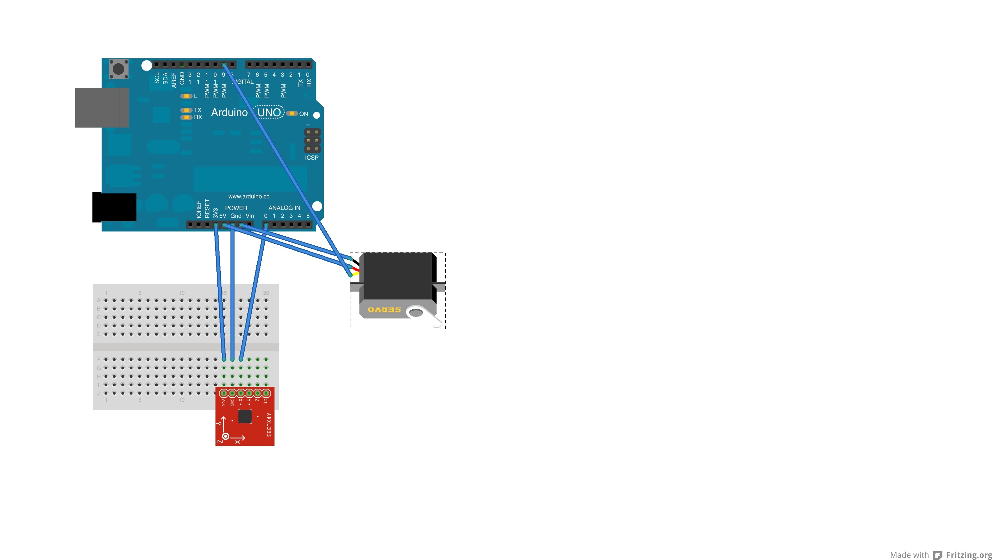

Hello,
I'm new to arduino, but not necessarily to programming so I'm guessing the code is written okay, just the idea might be wrong.
I am now facing a problem with my ADXL335 accelerometer, which is supposed to control a servo.
I wrote code which averages 10 values and maps that average value to the servo. Also puts the servo value out on the serial monitor.
Now the strange problem is:
Serial monitor shows perfectly averaged, non jumpy, values, even when accelerometer is moved quickly. But as soon as I plug the servo to the Arduino Uno and Digital 9 (PWM), the accelerometer values become jumpy on the serial monitor and you can see that in erratic servo movement.
Can anyone help with this issue? I have seen the ADXL335 work nicely on videos, but can't get it to work.
If you have time on your hand, you could look at my code.
Thank you!
-Phil
