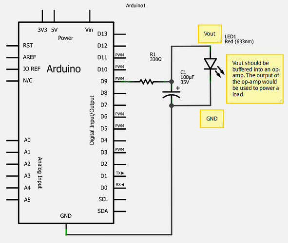

I should have specified that earlier. Lets say I have a low pass filter. It uses a 10k ohm resistor, 100nF capacitor, and a PWM output of greater than 32kHz to create any voltage between 0V and 5V, or a voltage divider. The current produced is very limited, due to the resistor. I would like the current boosted, but the voltage should stay the same. That current would be used to power a device or component. The more current capability, the better. I also will use that current to power an LED (using a 330 ohm resistor to limit current, but change the voltage).
Current: the more the better
Voltage: 0 - 5V
Application: powering components

How will I wire the circuit to the op-amp (pin-outs)? Lets say I am using the low pass filter described above.

Does the capacitor go to ground? seems to me it should... If it does then the available current is equal to the voltage divider formed by Xc (100nF) and the 10K resistor.
So we have 1/2Pi X F X C and a 100 nf capacitor has about 50 ohms of reactance @ 32 Khz If the resistor is going from the PWM Pin to the capacitor and the capacitor goes to ground (classic 2 element Low Pass Filter) then you have a 10K resistor connected to a 50 Ohm Reactance @ 32 Khz at the junction of the resistor and capacitor. The capacitor is a filter in that it will store some current from the PWM pin through the resistor... but there will only be about 500 uA of available current (5V/10,000 ohms).

Right now, my only concern is about how to use an op-amp (where to plug the ground, Vcc, voltage input / output, etc.) to power a load that takes 20mA or more (e.g. LED). Take a look at Low Pass Filter.png. With the op-amp, the LED would be at the output of the op-amp, not where it is now. Would something like "OP-AMP SINGLE BIPOLAR/8P DIP" or "SINGLE JFET-INPUT OP-AMP 8P-DIP" be okay (from Sayal)? Where How will I wire an op-amp to this circuit?

I get what you're trying to do here -- you're using the cap to "smooth" the PWM and turn it into a lower constant voltage. However, you need some sort of feedback to monitor the voltage and adjust the PWM frequency as necessary to maintain that voltage. Otherwise, with little to no current draw, you'll eventually fill the cap and the PWM does nothing. At higher current draw, the cap will empty and you'll just get PWM with a smoother waveform. Since op-amps are ideally infinite impedance, you'll probably lean toward the former.
Also, you might want a higher-order filter to smooth out more ripple.
Anyway, barring those difficulties, your op-amp would be a simple voltage follower arrangement:
Op-amp Vcc to +5v
Op-amp Vee to ground
Op-amp - input to op-amp output (unity gain feedback loop)
Op-amp + input to the output of your PWM filter (where the LED is now)
Op-amp output to its - input (as noted) and to a current-limiting resistor and LED
