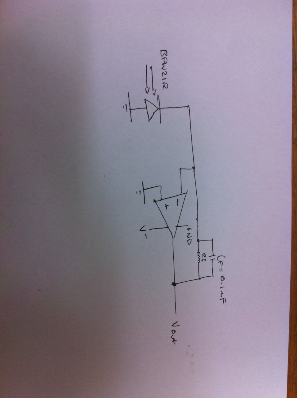

Now back to your questions and circuit: first of all please make a diagram of what you have so far so that we can talk of something more real than just thin air.
Second, the amplifier gain, assuming we are talking of an inverting amplifier configuration, is determined by the ratio of two resistors: the one on the feedback connection (from the opamp output back into the negative input) and the one on the negative input.
I believe a little bit of basic knowledge about opamps would help you here, so these are the two rules about an ideal op amp (real op amps do their best to match the ideal op amp) 1. no current flows out of an opamp 2. the op amp output will do it's best to make it's inputs to be equal in voltage
When selecting an opamp you have a lot of considerations to do, one being the supply voltage.
Every op amp will need some voltage supply in order to drive the output. When an opamp is classified as "single supply" that means it can usually be powered by 5V. When such characteristic is missing from the opamp description it means we are talking of "dual supply" opamps, which require 12-15V. Usually, when talking about Arduino, you want to stay within the 5V range, so pick a single supply one.
Another opamp characteristic is its capability to have the output going close to it's supply (speaking of voltage here). So assuming we are talking about a single supply opamp (5V) we talk about a rail-to-rail opamp when the opamp output is capable to go very close to the supply voltage. usually it's easier it goes very close to the positive voltage and a little less close to the negative voltage (or ground).
So, I assume you need an opamp that swings it's output between 0V and 5V while being supplied 0V and 5V: this is a single supply rail-to-rail opamp, like the MCP60x opamp family somebody else was suggesting (http://ww1.microchip.com/downloads/en/DeviceDoc/21314g.pdf).
Now, please, draw a schematic of your circuit naming your components and providing values so we can discuss the specifics.

Attached is the circuit im finding all over the internet and the one im trying to implement. You mentioned that the gain is controlled by 2 resistors. I understand that the gain is controlled by the ratio between the two resistors Vo/Vi = - R2/R1. However the circuits im finding for the transimpedance amplifier always just have the one resistor for gain control and one capacitor in an attempt to control noise.
Currently im using the LM324N - i think its a pretty general purpose.
I hope to end up using the TL072 as it has low noise and JFET input.
I forgot to write the value of the Rf - in my circuit currently, its at 100 ohms

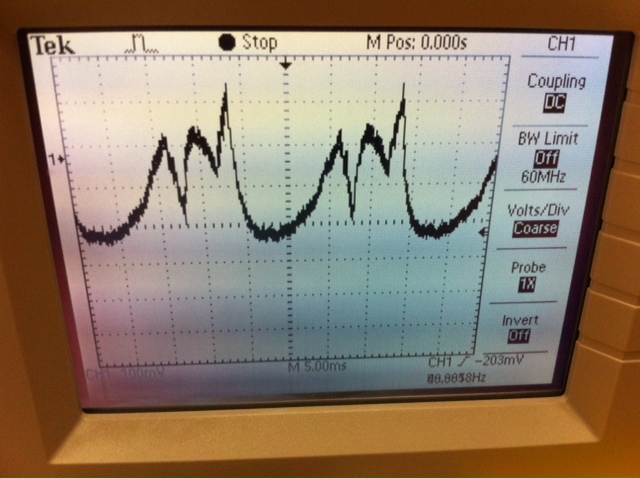

Here are some images from my oscilloscope. I changed resistor value to 1 M ohm and capacitor to 1 nano farad.
The circuit is responding to light and lack of light but not in the way expected.
photo 1 shows ambient light
Photo 2 shows when i put my finger over the photodiode
and photo 3 is when i shine an intense light on it - i think the oscillations increase when i do this also.

the oscillation you see in pic 1 is the sinewave from your AC bulb ;) 1/0.020 = 50Hz the oscillation on the pic 2 is a capacitive coupling of the sensitive input and high gain amplier with your finger. Your body create a big antenna as explained in other topic 1M is a very high gain!
To give you an idea my laser harp sensor "see" scattered laser light at 3 meters with only 220K of feedback in my I/V converter!
the LM324 in not rail to rail input/output and even if they said "low voltage" it's for biased input not from groud to V+
it's for AC signal with V+/2 bias at the input and the output will move around the Vsupply/2. this is why we must use AC coupling capacitors in that case. for your application you must use a rail to rail in/out amplifier or +8v/-2v supply voltage to get à +5V swing voltage at the output.
look this circuit:
R3 and R4 makes a voltage divider to VCC/2 for the V+ input. it's a single voltage application. and you have AC coupling capacitors (C1 and C2) at the input and output to remove the DC bias voltage
from LM324 datasheet: Large Output Voltage Swing 0V to V+ − 1.5V so you can get the ground but only 3.5V max with +5v supply. over this value the signal is deformed
Thank you genesis92 for your input. First im just experimenting to see if it response to light at all. I have reached where it clearly does respond to light.
The difference between dark and very bright gives me a voltage swing but only time will tell whether that swing is large enough.
