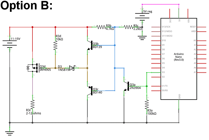

PWM control of significant current just about demands the use of power MOSFETs. Power MOSFETs however have notoriously high capacitances at their gates - which means that switching times are the largest cause of heat production. So, to minimize heat, switching speeds need to be maximized.
Push-pull circuits appear to be one of the most used (effective?) methods of minimizing time taken to switch, so after some digging, I've come up with an approach I hope will work. I found two variants of this; the only difference between the following two schematics is the placement of the transistor (Q3a) used to trigger the push-pull transistor pair (Q3b, Q3c).
Note: I don't understand exactly how or why push-pull arrangements work (I've read through some descriptions and have yet to have it sink in. I suspect wtih time (maybe osmosis), it will). So, I welcome any and all suggestions, starting from scratch, etc...
Game on. :smiley:

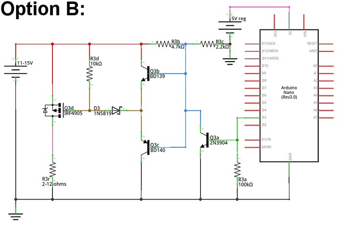

But diode D3 turns it back into a pullup+pull driver. No current from Q3B goes towards the MOSFET so it does no pushing.
Just buy the correct driver chip. They can do so much more than you can do with three transistors.

Morgan, your comment about diode D3 is exactly what I'm looking for. Thank you. As I mentioned a bit earlier, I actually would like to pursue the discrete component solution as a learning tool. (Whether or not it's used in the finalized project is beside the point.) That said, I am also going to look for a more integrated solution (single automotive driver chip, or n- or p-channel driver plus MOSFET). Also, your suggestion of the BTS716G had me excited. ...until I saw that it's not through-hole, and doesn't carry enough current (I need minimum 7 amps continuous). :frowning:

To be able to quickly switch off a P-MOSFET, it is best to use a voltage higher than the supply voltage at the Drain. Driver chips for that generally use some kind of voltage-doubler circuit, which means they need an external capacitor or two when they're creating that voltage.
Finding a simple driver without the voltage booster might be more difficult.
