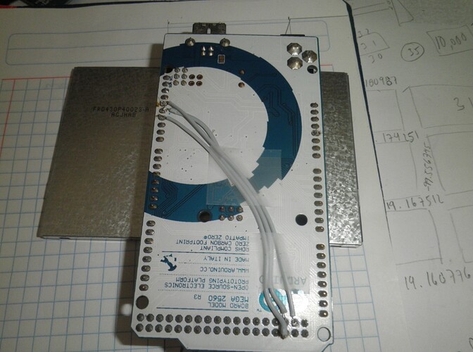

The arduino MEGA does not have the SPI bus on pins 11,12 and 13; it is located on pins 51, 52 and 53.
If you want to enable those pins for compatibility with any shield, you can direct the signals through three wires
I used that modification to be able to connect a gameduino 3, here is the result:
it still dosent want to work? ![]()
its a arduino mega clone , does that mean anything?
