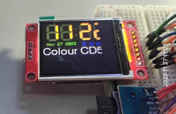

I tried to run the TFT_eSPI examples for ST7735 1.8 128*160 TFT display on two TFTs ( I bought from the same seller) connected to my ESP32 but both of them show the same problem : a part of the screen is either black or with garbage.
Here is an example when running TFT_Clock_Digital
I tried in User_Setup all the suggested configurations for the ST7735 driver (GREENTAB and its variants, REDTAB, BLACKTAB) with width defined as 160 and height defined as 128, with MOSI 23, SCLK 18, CS 15, DC 2 and RST 4.

Hello there Bruno! This looks like just a little mistake. Although you're using the display horizontally, its settings in User_Setup.h should be done like it's vertical. So, as you said:
Try using widith defined as 128 and height as 160 instead. I hope it helps!

thanks for your prompt answer and for your suggestion that solved my problem.
Since I hadn't found in User_Setup the combination of height and width you correctly suggested I erroneously thought that it was not allowed and I hadn'tried it.
Moreover I hadn't realized that the measures of pixels in this screen are supposed for a vertical position.
