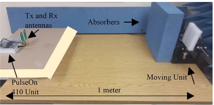

A 5 second search shows some researchers are trying UWB radar for measuring respiration rate.
It is not a simple task in real life settings, as the following paper shows.
But if you include arduino in the search, you will find a video of someone who made a crude radar respiration rate sensor that appears to work, sometimes.
