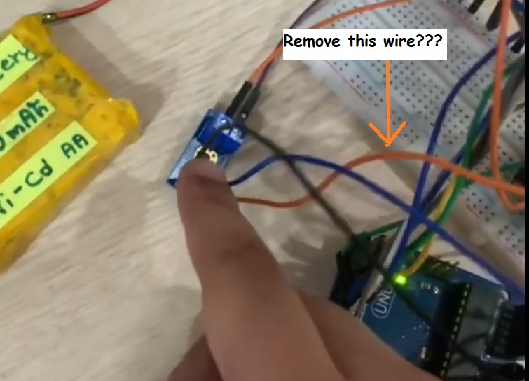

hello, I made a very simple project that turns on the 10 Segment Bar Graph LED Display to show the percentage of my 6v 700mAh Ni-Cd AA battery pack that is connected to a voltage sensor. This is all connected to an Arduino Uno. The problem is that when I upload the sketch, the voltage sensor is giving the right voltage (I have checked with my Multimeter) but as soon as I touch the power supply wires of the voltage sensor, the 10 Segment Bar Graph LED Display turns on and the voltage sensor starts giving random values. I tried giving the voltage sensor an external power supply (another Arduino Uno) and connected the grounds but, no difference. I am learning Arduino since 6 months so feel free to correct me. Thanks

Test your sketch by the usage of a potentiometer instead of "voltage sensor".
Which wires are those? Where did you find wiring instructions for the module?
I think that this "sensor" is a very dangerous joke. A voltage divider does not deserve a power supply, so the third pin most probably carries the full input voltage.
It is kind of a mystery, isn't it? And a dangerous tool to leave around the shop with no instructions at all.

I kinda checked most of the videos and websites and all of them showed the same wiring to the same pin

They're Female to Male Jumper wires

What power supply is your Uno running on?
Please include it in your schematic.
Have you tried putting a 0.1uF capacitor between gnd and the analog input A0.

the Arduino Uno Is running on a USB connected to my computer
and I have already sent a video in the previous replies
If you look at the video you posted in post#9, the + terminal of the module is not connected, yet you do with an orange wire.
Can I suggest you remove the orange wire completely.

Have you removed the orange wire I pointed out in post #19?
