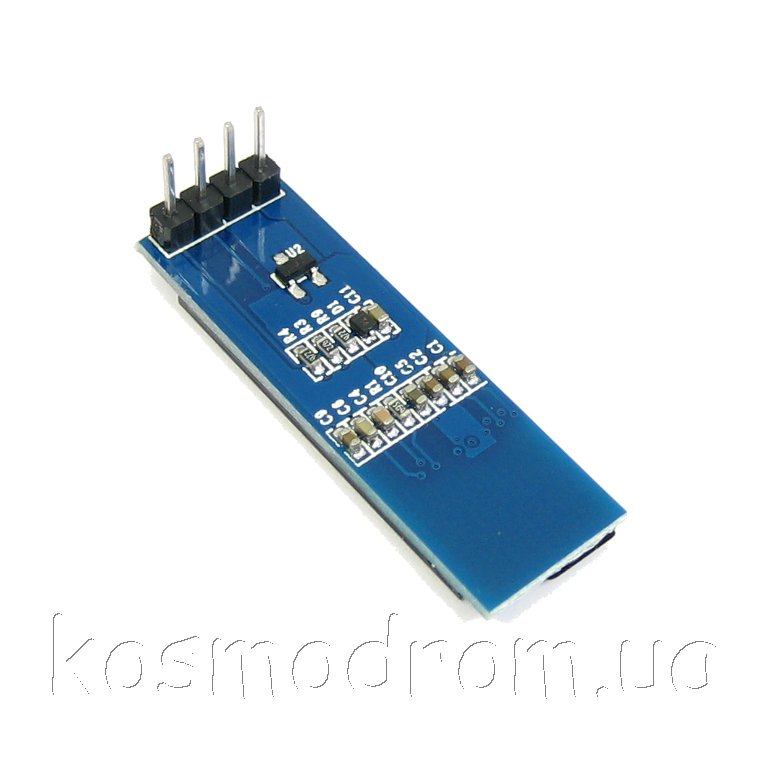

OK, I have had a closer look at the eBay advert and I see that there are level translator chips on the back of the board! These also feature in the blurred schematic although I cannot read the part numbers. This is unusual for a Chinese product! Can you tell me what codes are written on those chips?
So we can abandon the idea of using level translating resistors which is not a good idea when level translators are already in the circuit!.
Also the display appears to have a 5V to 3.3V regulator so you can power from 5V. So try this.
The board also has an R+C reset circuit. I have known cases where a proper reset is not generated if the supply comes up slowly. (This fits your symptoms as disconnecting ground and reconnecting it will reset the display chip). Connecting 5V tot he display VCC may help here as the displays 3.3V regulator will then not be in series with the Nano's 3.3V regulator so the supply rise time will probably increase.

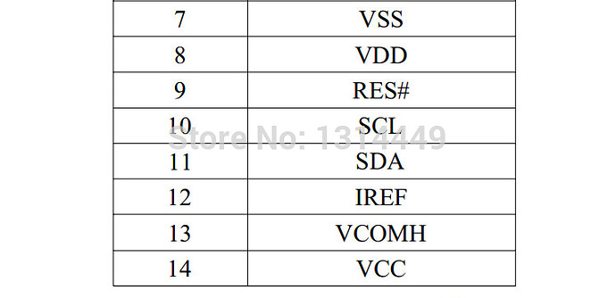

EDIT: found an picture for this display... attached for the internal pins from the display to the board. (attached)
2nd EDIT: found image of my display... same prints on the backside.
OK, it looks like 3 of the ICs near the signal pins are these level translators: "SN74LVC1G125 Single Bus Buffer Gate With 3-State Output". So that is good and you can drive them with 5V logic.
The 4th chip will most likely be the 5V to 3.3V regulator.

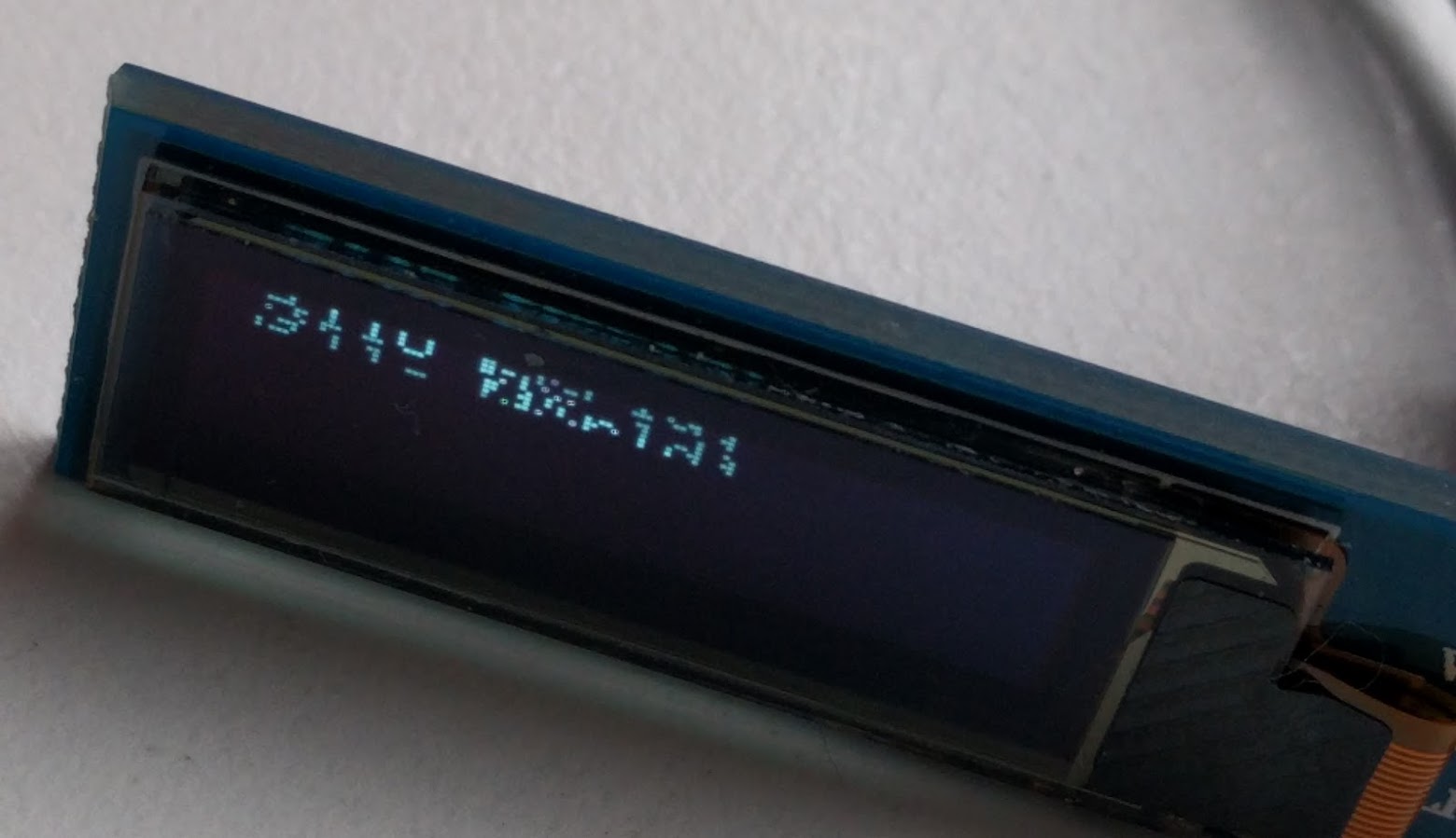

Seems like there is something not working correctly... if the display came up correctly i can see the adafruit logo, the small pixel at 10,10 and after that a "Hello World!" But if the loop cycle comes up, the screen will not cleared completely and the text will scrumbled up and the scrumble will change every loop.
See attached pic. Looks like the display does not clear the cache, or buffer or other stuff.
Is there a soft reset possible? Or any other idea?
