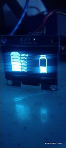

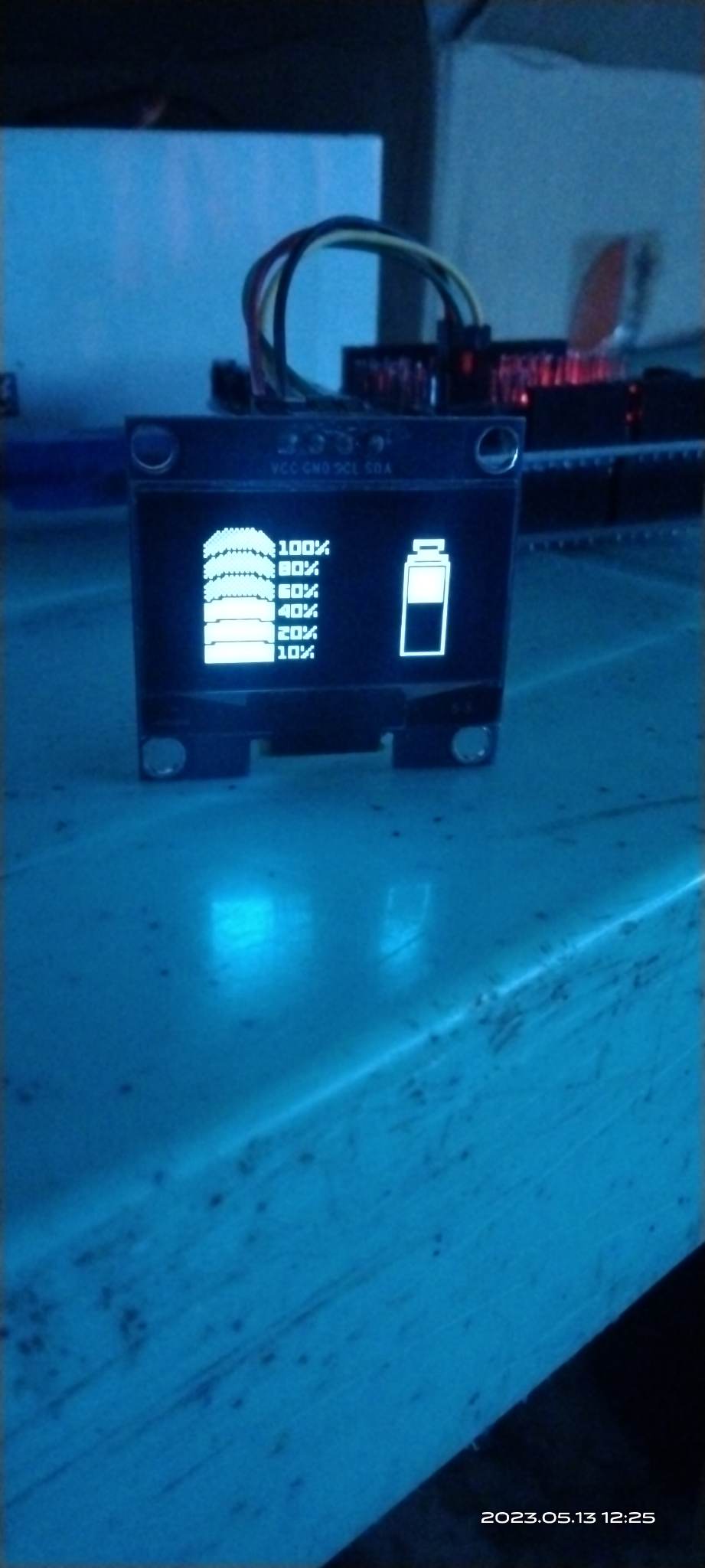

Hello everyone I'm currently working on my project water level indicator and I'm using OLED display to display the output. I'm trying to draw a box using drawBox() and map() function to fill the container from bottom to top but the output of my code draws box from top to bottom. How can i fix this?
Here's my code:

int progress = 0;
  OLED.begin();
  OLED.setFont(u8g2_font_t0_12b_mf);
  OLED.setColorIndex(1); //White color
  OLED.firstPage();
  do {
  OLED.drawXBMP(0, 0, 128, 64, epd_bitmap_water_level__1_); //Image
  OLED.setColorIndex(0); //Black color
  OLED.drawBox(95, 22, 16, 36); //Empty container
  OLED.drawBox(96, 23, 14, map(progress, 0, 100, 0, 34)); //Filling the container from bottom to top
  } while ( OLED.nextPage() );
  if (progress < 100) {
    progress++;
    progress = 0;
Output:
transpose 0 and 34
  OLED.drawBox(96, 23, 14, map(progress, 0, 100, 34, 0)); //Filling the container from bottom to top
And the colors black and white:
  OLED.setColorIndex(1); //Black color
  OLED.setColorIndex(0); //White color
This will fill a black box with white box from bottom to top.
Move the box position along with the box height, so that the bottom of the box is maintained at the same location.
    int barHeight = map(progress, 0, 100, 0, 34);
    OLED.drawBox(96, 23 + 34 - barHeight, 14, barHeight); //Filling the container from bottom to top
Thankyou. I can now continue working on my project.:blush:

int progress = 0;
  OLED.begin();
  OLED.firstPage();
  do {
    progress++;
    progress = 0;
Output:
Thankyou😊
