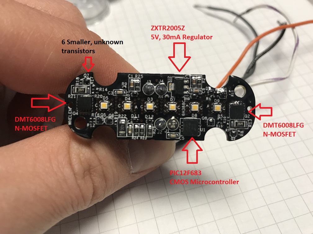

So to bring more clarity to this topic, I took a picture of the inside of the module (back of the board is unpopulated).
Main components I could identify are as follows:
Controller:
PIC12F683
[link http://ww1.microchip.com/downloads/en/DeviceDoc/41211D_.pdf]http://ww1.microchip.com/downloads/en/DeviceDoc/41211D_.pdf[/link]
Likely powered by 5V, 30mA regulator:
ZXTR2005Z
[link https://www.diodes.com/assets/Datasheets/ZXTR2005Z.pdf]https://www.diodes.com/assets/Datasheets/ZXTR2005Z.pdf[/link]
There are two N channel MOSFETS:
DMT6008LFG
[link https://www.components-mart.com/datasheets/82/DMT6008LFG-7.pdf]https://www.components-mart.com/datasheets/82/DMT6008LFG-7.pdf[/link]
There are 6 LEDs that I cannot identify... and what would appear to be 6 very small transistors (my guess as they have a 'Q' designation).
I don't see any evidence of any other components like inductors that I have seen in switching regulators. Only small caps, resistors and a few diodes present.
My initial guess was that the PIC controller is switching the larger MOSFETS to turn the LEDs on and off, but the coincidence of 6 LEDs and 6 smaller transistors is throwing me off. These light modules are intended for automotive use (emergency vehicle light bars etc)... so perhaps there is something going on to protect the LEDs from voltage spikes produced by the vehicle's electrical system.
