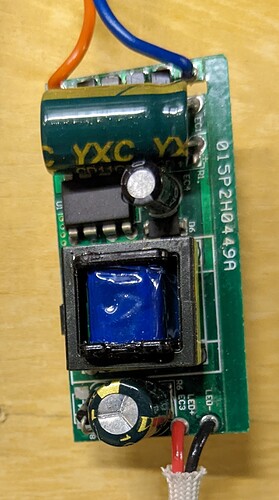

The LED drivers are indeed the ones that are mains powered and have the capacitor on the output that you are concerned about.
Drivers:
Inside:
The basic PWM circuit:
(I know! That's not a proper MOSFET symbol, I am too lazy to hand draw them properly.)
The MOSFET needs to be N channel, logic level with a high enough drain - source voltage to withstand the highest possible output voltage from the LED driver.

I didn't know if this would work, I had similar concerns to those @Paul_B expressed but my attitude to electronics is to try things, to see if they work. I consider that I knew what I was doing and I knew the risks. Something might have gone up in smoke, I understood that and tried it. Nothing went up in smoke.
  • Version 1 had 1 MOSFET controlling all 8 LED lights, which worked fine but I wanted to control them in groups of 2.
  • Version 2 was built on perf board and had 1 MOSFET for 2 lamps, 4 MOSFETs for 8 lamps.
  • Version 3 is on a PCB and uses a Microchip TC4468 MOSFET driver to drive FQPF20N06L MOSFETS.
  • Version 4 is just an idea at the moment, I am not happy with the wood backboard, I would prefer if everything were on a sheet of earthed aluminium with an aluminium cover.
I built the first one at least 5 years ago and there have been no problems with the lamps or the drivers, I've not had any fail so far.
Safety
If you want to build this please only do so if you understand how to work with mains safely and understand that @Paul_B 's concerns are legitimate. Mine works, yours might not, be prepared for that.

I tried this. The outcome is flashing white light. Kind of like a strobe effect. It does not dim. I think what happens is that the voltage goes below the LED's threshold and just turns off instead of dims.

The whole point of PWM is that the LEDs are turned on and off quickly, so quickly you don't see the flashing, they just look dimmer. I am not convinced you really did PWM. I'm also not convinced you used a logic level MOSFET.
Please post your circuit and your code (don't forget the code tags </>).

You just found out that constant voltage and constant current drivers behave differently. If one supports PWM control this does not mean that the other one supports it as well.
I'm now aware of this and the result is that one dims and the other flickers. Having said that, is there something I can do to support my requirements? Change the driver somehow while keeping it as small, but still having the ability to dim from within the led tube and NOT before it?
