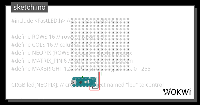

From reading various projects, I am assuming that I can use a 5V, 15A power supply and connect those wires to the WS2812 supplied wire in the middle and to the UNO R3 on the 5V pin? Then connect the data in wire to the selected pin on the UNO (I chose pin 6), the red and black to the power supply? I am also thinking a 300-500 ohm resistor in between the power and LED?
Read about the 1000uf electrolytic capacitor bridging power and ground... have a read as you wait for it to arrive.
And here is a practice page for you...
No, between the Arduino 'output pin' and the module's 'Data In'.
What's interesting with these modules is how the chain goes - some have each row left-to-right, others "ox-plow" fashion (left-to-right, right-to-left,. . .).
You'll find everything out by running the various examples available (Adafruit, fastled, however, whichever).
