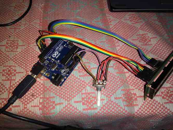

16x2 lcd not initialized properly.I wired with uno carefully and i used library example program(hello world) but still it showing black boxes on top row.please help me

It may help if you show us a clear picture of your wiring.

Until we get a proper photo of all your assembly, taken in outside daylight with a real camera, we probably cannot help you.

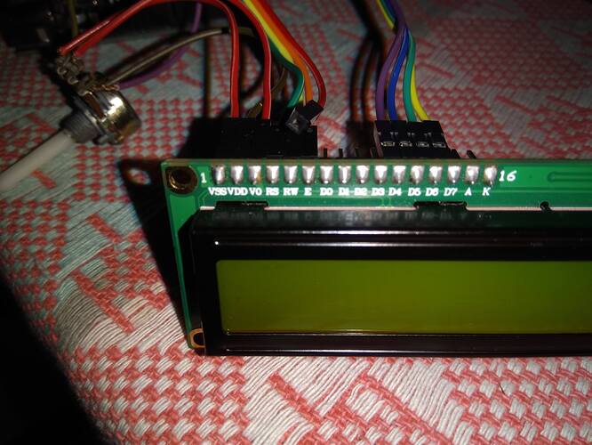

In the lower picture (who did upload these pictures?) it looks as if pin #1 (VSS) of the lcd display receives a red wire and pin #2 (VDD) a brown wire. If red means 5V and brown means GND then these wires are swapped. The wiper wire (also red) seems to be positioned OK that is connected to pin #3 (V0).
Actually your pictures give the impression that there is some backpack print with connectors at a 90 degrees angle. Hard if not impossible to judge the connections.
Please have a look at How to display Arduino sensor data on a ‘classic’ lcd display – thesolaruniverse
It looks as if the LCD header pins are properly soldered with respectable Dupont wires.
However the potentiometer looks as if the wires are just twisted by hand. This in unwise (tm).
Quite honestly, you should get a visible display if you forget about the pot. Connect #2 to 5V. #1, #3 to GND with proper Dupont wires.
