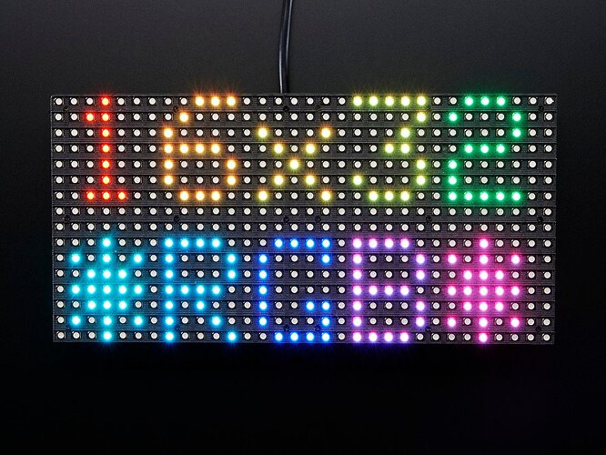

16x32 LED Matrix not powering/displaying correctly
Hi all, I'm a arduino newbie and I recently got this 16x32 LED Matrix to start playing around with displays w/ the arduino.
I've run into some problems, and I was hoping one of you could lend some of your insight!
The goal is to get the display to run a test example that draws various shapes and then ultimately displays this
on my Arduino Uno, using this code and the supplied libraries:

Here's a preview of my results.
I am using this set up guide from Adafruit, designed specifically for this display. They don't include a schematic, but they have a page showing all the connections, which I've quadruple checked and ensured I've followed correctly.
I believe the problem is either with the outside power supply, the grounds on the board or possibly the scan rate of the display.

Part 1: Power
My display requires at least an outside 5v, 2a power supply via a Molex-style header:
Per Adafruit's instructions, I found a 5v/2a DC power source, and wired it directly to the molex:
The guide doesn't specify how to power the Arduino, but I have it being powered through the USB cable to my computer.
Problem: I have not been able to get the display to power through the 5v/2a power supply. When I attach the display to just the arduino and power it through that, I get the results in the video above. However, when I try to attach the display to the 5v/2a power supply via the molex, the display completely stops working.
I'm completely new to circuitry/arduino, so I'm not sure if it's my wiring set up or what.

And my actual board:
And to the display:
Problem: This display requires 4 grounds, but the arduino only has 3 ground spots. I've put two of the grounds in 2 of the GND spots on the board, but the remaining 2 I have connected via the breadboard. I originally tried to ground all 4 via the breadboard, but the display's LEDs started fading. So, I'm wondering if the lack of a 4th ground spot on the Arduino is causing my trouble.
