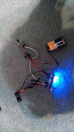

I have a 9V battery connected to the Vin pin with a rocker switch in the middle to turn it on and off. Other than that, I have everything hooked up acording to the wiring diagram on http://meedantech.com/ . The only difference is because of the limited ground wires, I have soldered the ground wire coming from the transceiver to the ground wire of the battery which is plugged into a ground pin on the nano. I can take a pic, but it is kind of a mess of wires.
Here is the transmitter
Hmmm OK . so if you load the stock "blnk" sketch does that run on the battery or only with the cable plugged in.
and where is the TX drawing its power from ?
Yes it does run off of the battery
The transceiver is drawing power from the 3.3V pin
ok so have you tested if the 3v3 pin is delivering 3v3 on battery power ?
and that the 5v rail is delivering 5v to the pot
Both pins are delivering the proper voltage
So here is where I'm at. I still dont know what the issue is but i have checked all the pins- the Vin, 5V and 3.3V and Vin- I am getting 4.9V from 5, 3.7V from the 3.3 pin and I hooked up a 9V battery to my Vin. I am getting 5V from the voltage regulator, has anyone ever come across this issue before? Also, neither the TX or RX lights go on when it runs off of external power.
OK so I found out that the FTDI chip only works when there is power coming in through the USB port. Could I take a mini USB cord, cut it in half, and connect the positive and negative wires to a 5v regulator and connect that to my battery? that would allow the FTDI chip to receive power right?
