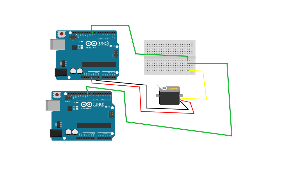

I got an idea of controlling a servo with 2 arduino. i.e, If I create a wifi servo controller with 1 arduino and some bluetooth servo controller with another arduino, can I connect the input pin of the servo to the digital 9 pin of both the arduino using a breadboard?
Example Diagram
Sorry for the weird diagram...
I want to know whether the servo or motherboard would get damaged or may cause any other problem. Just a doubt..
Thank You!

Probably not. They will constantly fight each other if they are both powered up. You would have to tell one Arduino to shut up while the other one is speaking to the servo, seems unnecessarily complex even if you got it to work.

Even if connecting a servo to 2 boards worked, which it won't, do you realise that the ESP32 is a 3.3V device and the Uno is a 5V device ?

Also, according to your diagram, only one servo would ever actually do anything since the servo is grounded only to one Arduino. You'd have to ground Arduino to Arduino as well (could do that on the breadboard easily enough) if you wanted to run your experiment anyway and see.

You could still accomplish what you're trying to do if you frame your idea differently and rework its general method. I think you've created an xy problem if I'm not mistaken.
Don't expect folks here to follow links. Tell us what you want to happen in the end with what parts, generally.
If you used one Arduino simply as a servo driver and another as a data interpreter from whatever your data source(s) are, this plan might work. I use multiple Arduinos in projects all the time (the one in my avatar uses I think 4).
Instead of that Fritzing diagram, why not draw a general diagram/flow chart what you want to make and see what folks here have to say?
