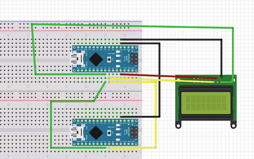

Im using 2 arduino (nano's) and 1 LCD on a I2C bus. The master arduino sends data to the slave (which doesnt send anything back, or acknowledge, it just listens on the I2C), and the master controls the display. Both arduino's are powered separately via USB. I simply put the SDA, SCL and ground in parallel, like this:
This works, but ONLY if both arduino's are powered on. When the slave is off, the Master seems to freeze. I tried adding 10K resistors between SDA and 5V and between SCL and 5V, but that doesnt help.
When the Slave is powered off, its input protection diodes will clamp the SCL & SDA lines to within 0.5V of its supply lines.
If unpowered, that's 0.5V. Both SCL & SDA low will keep I2C from operating.
