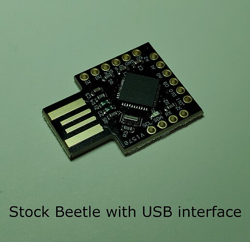

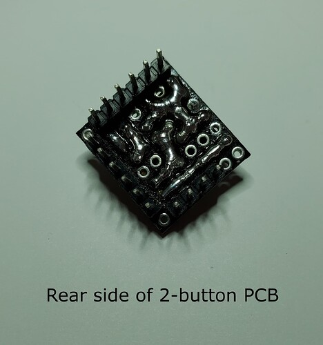

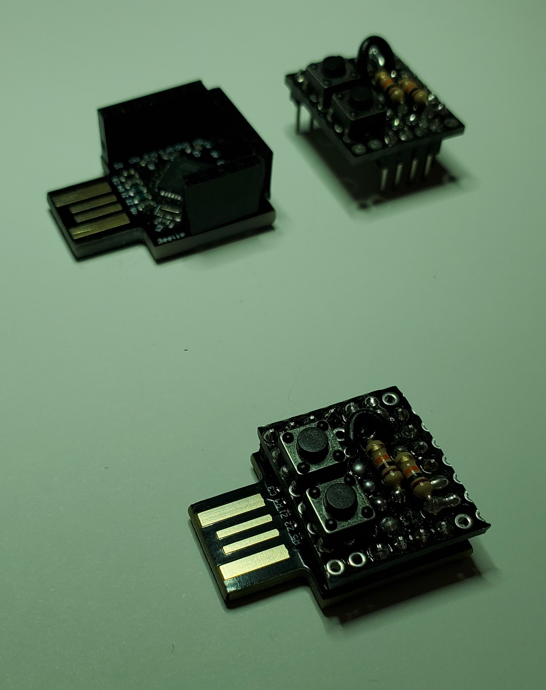

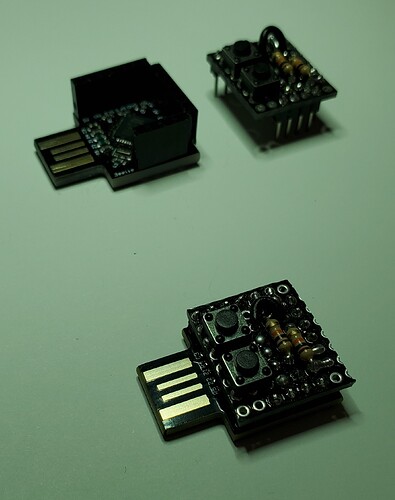

Image of 2-Button Beetle with PCB shield and directly soldered versions.
I have been asked to update my passwords monthly and to use longer passwords. This is my solution to remember passwords, seed phrases, key addresses and any other long string of text.
I used an Arduino Beetle with 2X momentary switches and a couple of pull down resistors to select and type my passwords right into the text box for me.
Requires the following:
1 - Arduino Beetle (Leonardo)
2 - Momentary Buttons
2 - 10k Resistors
1 - Small piece of PC Board
3 - Pin Headers (as shown)
Sample code: http://stievenart.com/Arduino/2-BTN_Password.ino

Simple, cheap, and portable project. Can hold and remember all types of text besides passwords. It can hold seed phrases, key codes and paragraphs if needed. Please do not share your personal information with no one.
