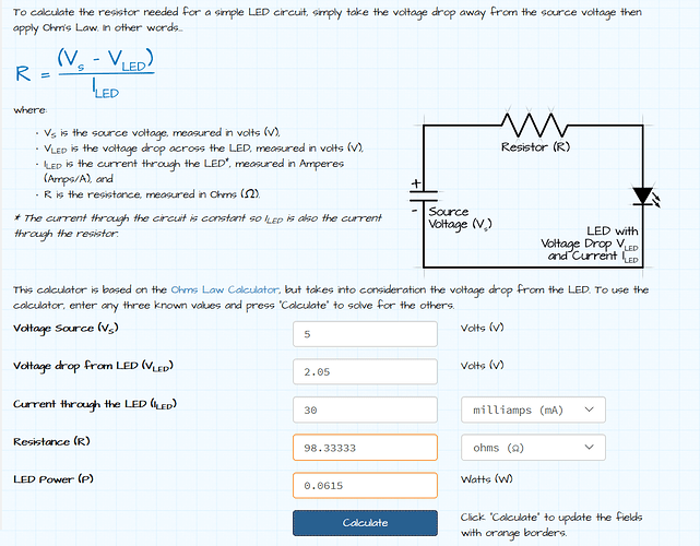

That does seem the easier option. I already had all the other parts, so think I may have been over complicating it. Could I just query the size of the resistor you suggested. You suggested 2.2k. Taking the info from the data sheet, I think it should work out to be only 100, but I may be wrong?
Output from the board 5V
Voltage drop across led 2.05V
Current 30mA
=Resistance required 100
As always, grateful for the guidance
Use 20mA per output as a safe current for the Arduino to use.
Many here find 220 Ω adequate for a single red LED.

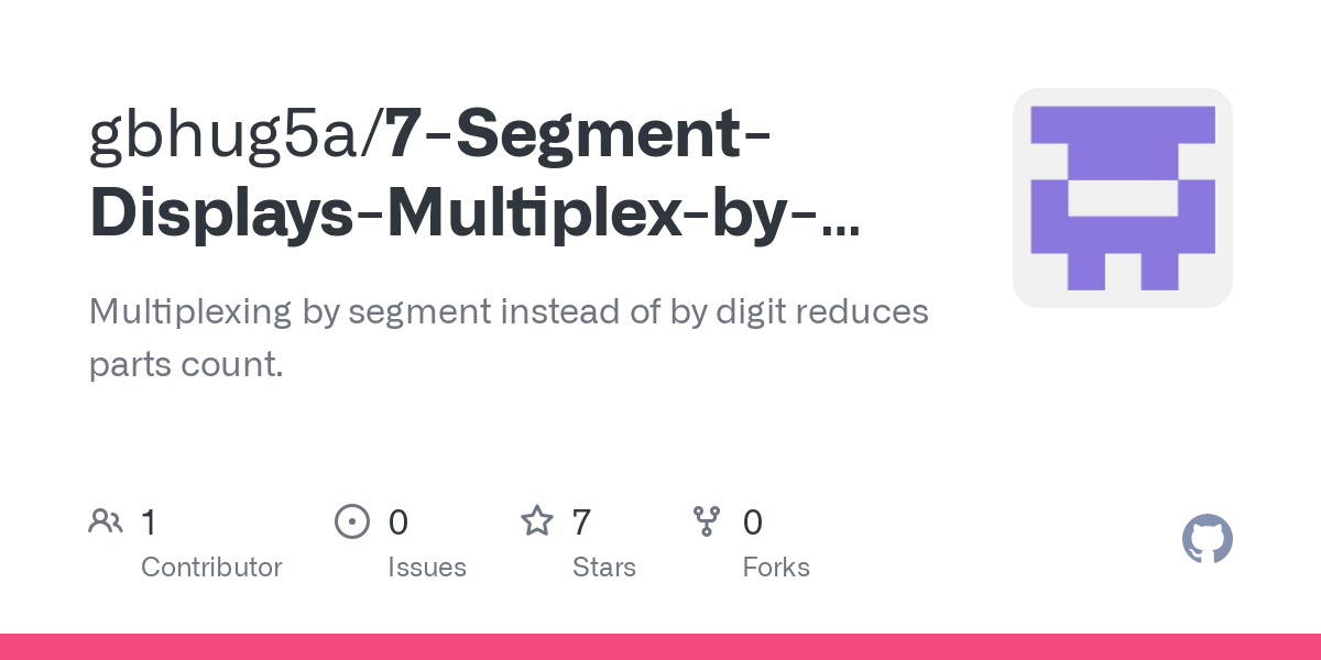

It should be said that 7-segment displays vary widely in their efficiency. Some individual displays, such as the Vishay TDSR1360-IK, are quite bright at low current values. Their reference datasheet luminance values are given at 1ma. I don't know of a 2-digit module with high-efficiency displays, but there must be some.
There's an alternate multiplexing option which would eliminate all of the segment line resistors, with just a single resistor in each CC line. You multiplex by segment instead of by digit.
The repo includes sample Nano code, and a reference in the ReadMe to a related video.

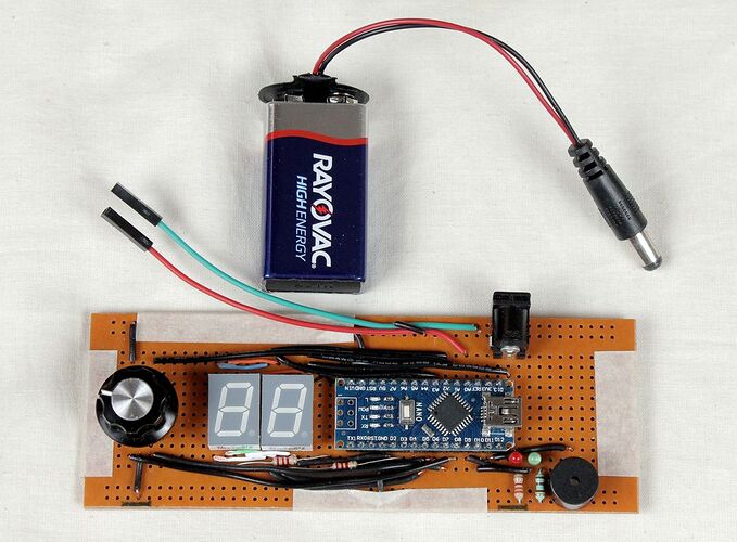

Yes, I think that's right. The primary purpose was to reduce the parts count. The only way you would gain anything on brightness is if the relationship between the duty cycle and human perception of brightness is not linear. I guess that's possible, but don't know if anyone has ever studied that, and my guess is that it's roughly linear.
That said, I built a reflow controller and multiplexed the displays by segment, and got completely acceptable brightness with 2.2K resistors on the common cathode lines, which at 5V less the 1.8V LED drop is about 1.5 mA per digit if "88" is being displayed. That's using the Vishay displays, which had intensity group K ratings, which give you a lot of brightness for your milliamp.
So I think finding the right displays is pretty important. Multiplexing by segment just simplifies your life on parts and layout, at the cost of having to refresh more often, but I don't think it gives you any power savings.
