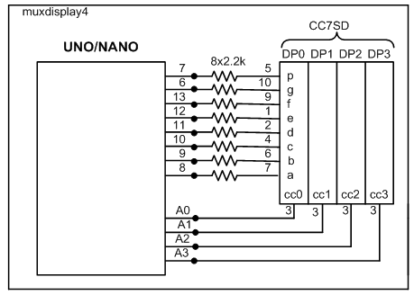

1. Let us build the following multiplexed 4-digit cc-type display unit. In a multiplexed display unit, the segment pins of the identical segments are shorted together except the cc-pins which are separately driven by IO lines.
Figure-1: Multiplexed display unit.
2. Let us write codes to operate the above display unit as a 4-digit counter of range: 0000 - 9999.
Addressing your issue in (2), it should work the same in both directions. I believe the 328P sources or sinks the same amount of current per I/O pin. The datasheet should confirm that. So if a pin can sink 8 segments of current from a common cathode display, it should also be able to source 8 segments of current to a common anode display. The issue, as you say, is how much current that will be. The HC595 should work the same way, and it has its limits just as the Arduino does, both per pin and in the aggregate. I think typically you will see people use transistors on the CA/CC pins to transfer the current burden away from the Arduino while still having bright displays.
Note that there is a difference in the efficiency of 7-segment displays. I have found the Vishay displays such as the TDSR1360-IK to generate a lot of light with very little current. There may be others like that.
But I want to address your option in (2a). I had the same idea, motivated by the prospect of being able to do away with all of the segment resistors, and the CA/CC transistors, and have only a resistor on each CA/CC line. That works if you're only turning on one segment at a time. But in the end I settled on multiplexing by turning on the seven (or eight) segment drivers one at a time, but also turning on the CA/CC lines of all of the digits which should have that segment turned on.
So if you are displaying "8888", you would turn on segment A along with all four of the CA/CC lines. Then you would do the same for segment B, and so forth. But for "4444", none of the CA/CC lines would be turned on for segment A.
The maximum current a segment line will have to source/sink is for four segments, not eight. And each CA/CC line never sources/sinks more than one segment. So you only need one resistor in each CA/CC line, and no resistors in the segment lines.
If I/O pins are scarce, an HC4017 would take the place of the HC595.
I thought this was so nifty that I made a video on it, and did a Github repo with demonstration sketches. The downside is that you have to refresh more often, but not really that much more often. For four digits using the traditional method, each digit is ON 1/4 of the time. In the alternate method, each segment is ON 1/8 of the time. So basically you have to refresh twice as often to prevent flicker.

It doesn't need to be anywhere near that fast. In the example shown in the video, I switch from one segment to the next every 2ms, which is 500 Hz. But that means the same segment is refreshed every 14ms, which is 71 Hz. If I had used the decimal point, it would have been 16ms, or 62.5 Hz. There is no flicker at that rate.
With this alternate method, the refresh rate does not depend on the number of digits. This is multiplexing by segment, so you cycle through the segment lines one at a time no matter how many digits are used. The number of digits only affects how much current the segment lines must source or sink.
With the traditional multiplexing by digit, to get the same 62.5 Hz refresh rate per digit, you would have to switch from one digit to the next every 4ms, which is 250 Hz. But with that method, the rate does depend on the number of digits.
