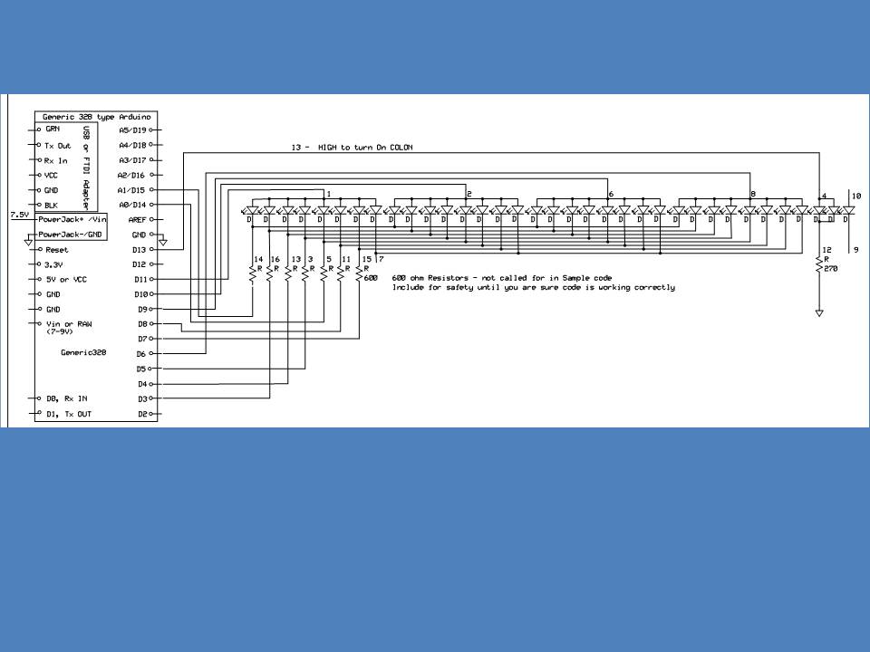

On the page you link, there is a sample sketch. In that sketch, it details what pins on the display to connect to what pins on the Arduino.
Have you connected it that way? Have you tried that sketch? Why not?
Well for some reason my computer says it can't open it so it moves it to a folder and I cant find that folder. It would be helpful if you could open it up and post the code online, if thats not to much trouble.
ok I found the sample code now how would I add the colon to the counting? I've tried to hook it up but I cant get it to work. Heres the sample code:

@ OP
does you 2 digit, 7-segment leds unit HAVE the colon in there?
most just have a period.. (not a colon)

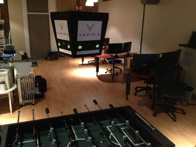

I did something similar, a completely automated foosball scoreboard:
It uses a trip laser in the goal posts and an RF transmitter / receiver to communicate. You can see more pics / a video here:
http://www.reddit.com/r/arduino/comments/reh4h/arduinopowered_foosball_scoreboard/
Thanks for all the help but I meant it's a 4 digit total display but I use two digits with the colon in between. Sorry in that screwed some people up.
Do you want the colon on all the time?
Connect: +5, 1K resistor, display pin 4. display pin 12 to Gnd.
Otherwise, instead of +5, connect to an arduino pin, like D13.
"how would I add the colon to the counting?"
Can't say, you haven't said what you want it to do.

The sketch does not appear to have the colon in it...?
Pins 4 and 12 (L1 and L2) on the 7-Segment display need to be powered. You will need to other digital pins (PWM not needed) and set them to high in the sketch.
@CrossRoads
Hi. Yes i meant a diagram of whats gets connected. Thanks XD
Schematic to connect display per the code above.
I show resistors to limit current flow, your call as to whether to leave them on or not.
