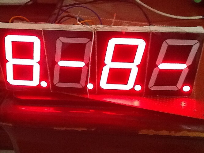

Hi, i know it's been years, but i miss 1 little thing and I could not find it :slight_smile:
I use the same program for scoreboard.
But I use Comman Anoda and I manage to invert the hex with no problem.
everything is working exept when I turn on the first and third digit all segment including DP lights up, which suppost to lights off until it reach 10.
Pressing the bottons players works fine.
I connect the pin 13 to the ground
I can not fine the problem. Anyone can help?
Thank you
"I can not fine the problem. Anyone can help?"
Not without seeing your code.
Also, your display should have current limiting resistors between the 74HC595 and the segments, and a 0.1uF cap from each pin 16 to Gnd.

The code is exacly the same as the first post on this thread from azbresky except I change 0x3F to B00111111, // 0
Etc
Yes I know I will use 0.1 uf cap on each segment to the ground.
I use comman Anode 7 segment, 5volt.
The attachment pic. Showing led lit when I turn on.
All digits lit are invert. (The 1st and 3rd digit suppose to be off)
I can not understand why it invert ?
Is it because I'm using comman Anode?
Is there anyway to invert ? The simple way?
Would it solve the problem if I use comman Cathode?
I'm not a programmer for sure.
Those 74hc595 will soon burn and you will have to replace with something better designed.
You have not posted your code, so we can't tell why your segments are inverted, but it would be easy to fix that in the code, for example with ^0xFF
The code is the first post of this thread, the same code.
Yes it will burn the 74hc595 (70ma) maximum and i already order tpic6b595.
Even I'm using 5volt led with 10ma each segment.
I can not make the frist digit and third off, but so far i can change the code with 0, so it become 0000.
