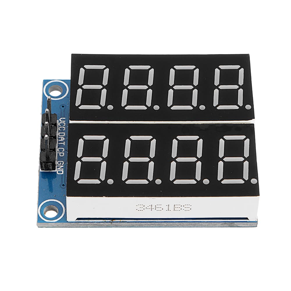

HC164 display

You have to understand that it is one 8 Digit display, and it is up to us to interprete it as 2 row 4 digit display. I want to display one temperature in one row, and such LED is visually more suitable for that, but we work with it as just one big line of digits. So I set up first 4 digits for the first temperature, and last 4 digits for the second.
Also in case of MAX6675 module naughty behaviour, you messing up contacts or just uncredited behaviour, you will read temperature value as "nan", and if you pass it as a float to the LED display it breaks it, and you have to restart your arduino through power down. I made it so if you recieve nan value, you send a "nan" as text to the display and it works.
With temperatures over 100, it can display only 1 digit after float point, and I made conditions, at which display shows 2 digits after float point at values lower than 100 and 1 digit at values higher than 100. I am not going to work with temperatures higher than 1000 so It is up to you to add condition for that. Without these conditions display messes up values, so you can't just pass any float value and expect it to fit it into 4 digits.

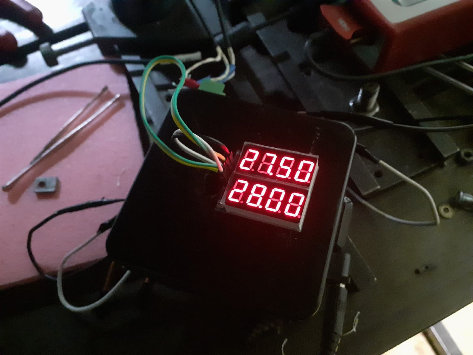

Here are images of pre final result, since I am aware that it looks a lot like orcish technologies, and due to some reasons, which I will unravel at the end, I will make it look much better, but in other project. Anyway it is working and not flickering.

p.s. After finishing the device, It became clear, that precision isn't sufficient. MAX6675 is a 12-bit resolution module meaning that display will show temperature with step of 0.25°C. It means that if you measure temperature between 27°C and 28°C, all possible values are just 27.00, 27.25, 27.50, 27.75 and 28.00. To count that the simple way you can divide your Thermocouple max temperature by 2 in power of bits, in my case it is 1024/2^16 = 1024/4096 and you get 0.25. So I now I need to undertake another project replacing MAX6675 with ADS1118, which is 16-bit module, therefore in theory I'll get 0.016°C step which is sufficient enough. But more on this in another project, so until then, have a good one, and I hope I helped you in some way.

I expect it to work intermittently especially as it gets warmer. You have the 5V overloaded, you need a separate 5V supply. A buck converter from the 12V to power the display etc would solve the problem but the grounds must be connected together. You did a nice job on the frizzy wiring diagram picture but it does not tell me much, a schematic is prefered.
