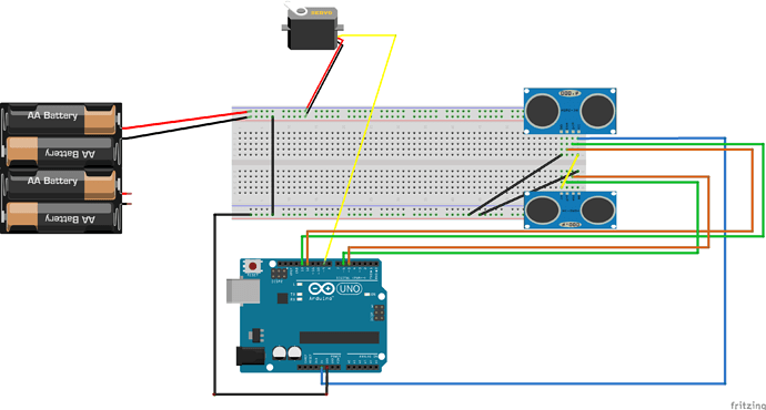

Hi guys,
I'm also experimenting on the subject of 2 sensors with 1 servo.
I have the 4 pin sensors (VCC, TRIG, Echo, GND).
The first one worked great, by seeing if the distance is < Xcm and then turning the motor if something is close.
When I connected a second sensor, I thickened the code to add all it's parameters, and said that:
if ((cm < 10) && (cm2 < 10)) {
    myservo.write(90);
    Serial.println(cm);
    Serial.println(" from #1 sensor"); //display the distance from sensor
    Serial.println(cm2);
    Serial.println(" from #2 sensor");
    delay(250);
  else {
    myservo.write(0);
    Serial.println("Too Far");
    delay(250);
What gets printed in the serial monitor is something like this:
Too Far
Too Far
8
from #1 sensor
0
from #2 sensor
7
from #1 sensor
0
from #2 sensor
4
from #1 sensor
0
from #2 sensor
Too Far
Too Far
The above situation happens when I place objects in front of BOTH sensors. So #1 gets distance, #2 doesn't.
So basically it's telling me that something is wrong with the input from the #2 sensor, because the cm2 variable is 0, so it doesn't pick up any distance at all.
I don't want to paste the whole code here because I think it might be the wiring, not the code.
Please take a look at the pic and tell me if something is wrong.
Take note of the Black and Yellow wires. Are they correct?
I hope you can understand the drawing. Just in case - the 2 sensor (I don't have the image), are in opposite order of the input pins, so the 4 right-most rows represent each one, where the sticker is.
Thanks!
I'm attaching the full code, since I tested the other sensor separately, and it seems to be working fine.
So it's either a power problem, which is unlikely, or it's a code issue. Here is the full code:
I would really appreciate any help on this.
Thank you! :slight_smile:

According to that pic, you have 2x GNDs and no power to the lower sensor. It has GND from the rail, and a GND fed from the upper one.
Side note: you also need to connect the servo -ve / battery -ve to Arduino GND.

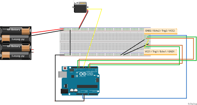

Hi JimboZA,
Thanks. I made a few mistakes in the diagram, sorry for that, can you take a look now?
I lack the image for the sensor, so I wrote 2 sensor with their exact pin order:
The top sensor has its pins going from GND2 as the leftmost (black wire) to VCC2 which is in blue.
The bottom sensor has its pins going from VCC1 as the leftmost (yellow wire that connects to the other sensor's VCC2) to GND1 (black wire)
There was also a wire connecting the battery to the GND, which I forgot to put in the drawing, now it's there.
Any ideas?
This is the way it was connected, I just updated the diagram to the correct situation it's in.
Thanks!
I have to mention again, that with the current setup, both sensor work if tested separately, but not together.
It must be a code issue. It is attached in the above posts.
Thanks.
You're still not showing power to the lower sensor.
Assuming it has power, I wonder if the issue can be to do with one's ultrasonic beam being read by the other and confusing it? Or are the pointing apart?
The pointing is apart, the sensors need to be able to display separate distances.
But - what do you mean there is no power to the lower sensor? the VCC line is connected between them (yellow) - from 5V on arduino it goes to the VCC2, then to VCC1...

Ok I didn't see the tiny yellow line but it's connect to the upper one's black and back to the lower one. So lower one has no power, still got 2x grounds afaics.
Sorry I don't understand JimboZA, what do you mean it's connected to the upper one's black? the GND2 and GND1 are connected both to the bottom row of the breadboard, and this way they have GND to the arduino.
What's the problem?
Please notice the order of the pins of the sensors, it's confusing but they are reverse from each other in terms of pin locations on thebreadboard.

Attached is also a schematic of the wire setup as it is.
It is important to understand that with a code made for 1 sensor, both sensor work when tested separately.
Notice please in the image the different pins of the sensors, they are in mirrored positions. you might have to zoom in a bit.
Thanks a lot! :slight_smile:
