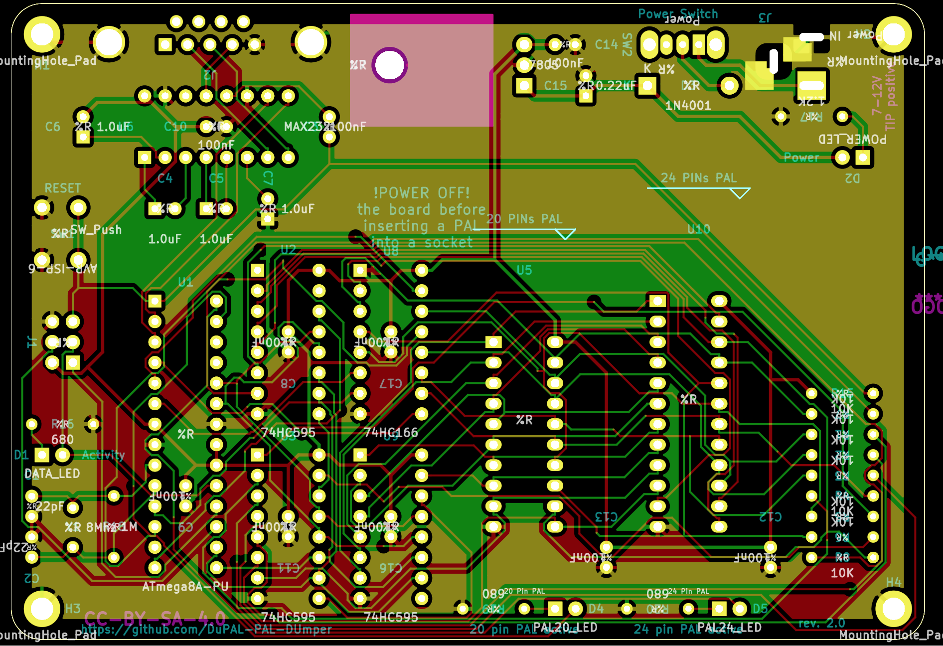

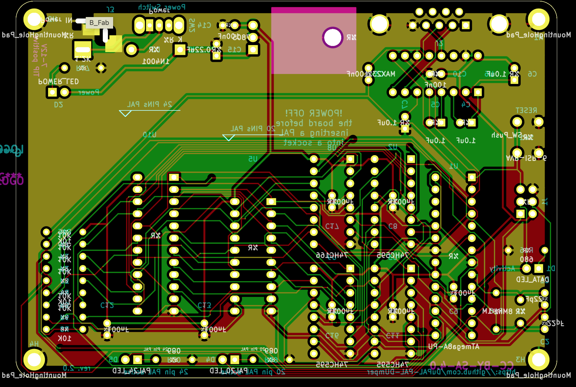

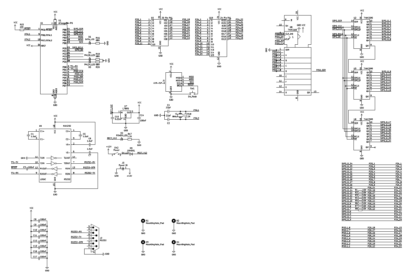

I did realize that there was an actual schematic in their repo, and after digging, determined it was a KiCAD schematic. So, I did get KiCAD loaded and spent the past hour learning how to fix missing component symbols on the original schematic from the repo, exported it as a PDF, and then placed it in my Git repo:
This looks pretty accurate from what I see on the board. The only difference is that the schematic mentions an 8A vs. the 328P that is mentioned on the Git repo to actually install on the board. These are pin compatible, and I only assume they upgraded to the 328P because it was necessary.
The pictures of the board coupled with the schematic hopefully can help a bit now.

This is as professionally prepared schematic, and quite standard, but the crystal is specified as 8 MHz.
Original PDF (higher resolution) attached below.
dupal schematic.pdf (235.5 KB)

Thanks for the feedback on some of the schematic errors, too. I’m guessing the open source author did not correct a few things on their schematic document when they committed new versions of the project to their repo. (I.e. this looks like it started with an Atmega8 and an 8MHz crystal, and ended up with an Atmega328P and a 20MHz crystal.). I’ll fix the issues and offer them a merge request and see if they accept.
