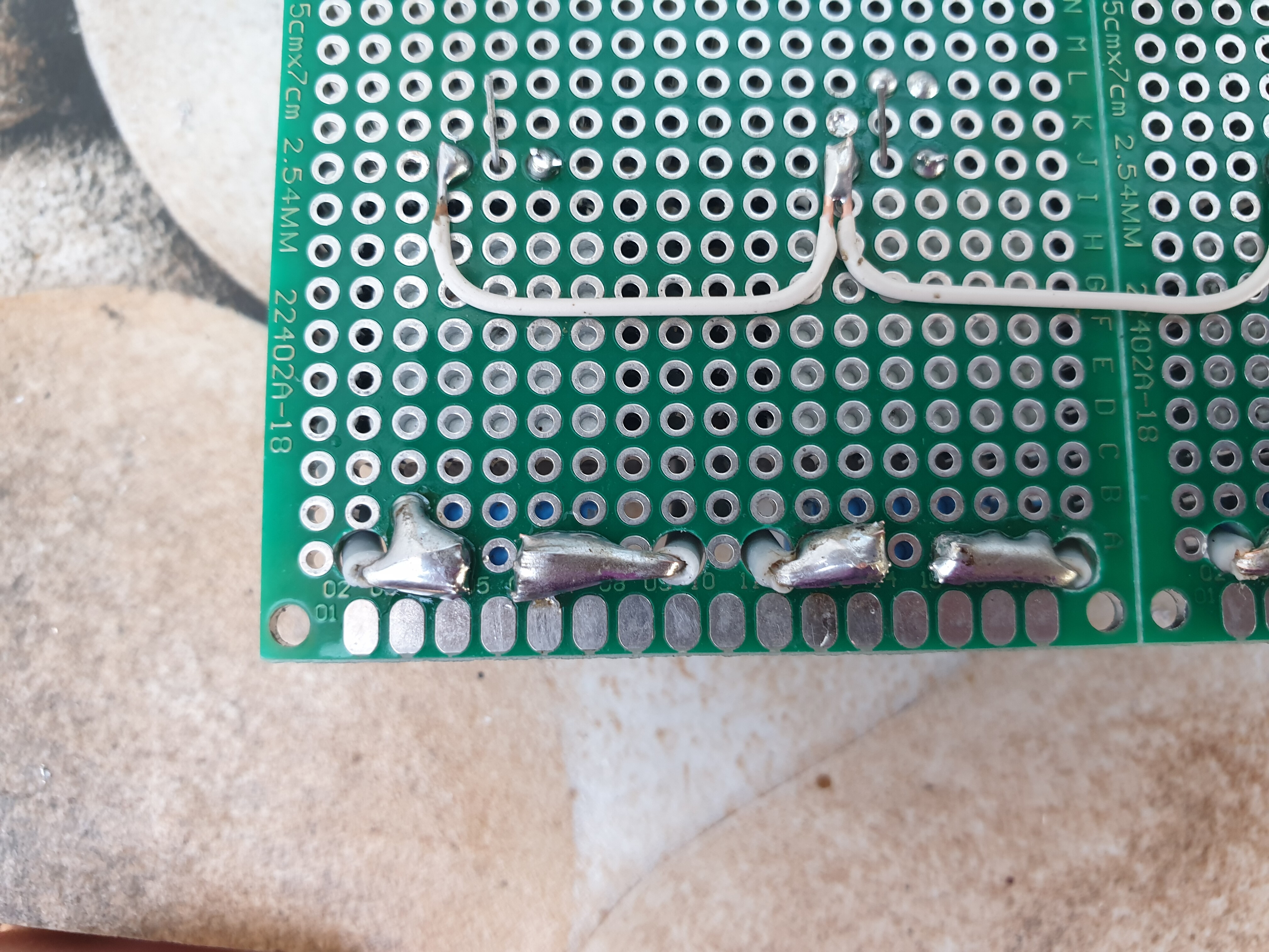

Can i run 220v max 1A on 22AWG ethernet wire from the screw terminal on a pcb to the common pin of a relay, about 2cm ?
Is the wire rated for 220v ?
I don t know i believe not

Also, you need to know the voltage rating of the insulation. As it's ethernet wire I wouldn't use it myself.
I found that on google but the ac voltage i was not sure if it can stands. I havo no ac insutated wire that fits in pcb holes
You really ought to run it between screw terminals.

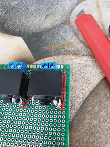

To be honest, it all depends on how properly you want to do this. There are all sorts of rules for products that have mains voltages in them. For example, those exposed relay terminals wouldn't be allowed. If it's just for you, it's up to you to decide how much risk you are willing to take.
My relays pins doesn t fit in the holes and i places it on one side with the pins
Understood. But exposed terminals like that are inherently unsafe for anyone working on the circuit while it is live.
The relays are built so that the low voltage side (the actuating coil) and the switch contacts are kept apart, you need to follow the same logic.
The way you have the relays laid out, with the low voltage side wires right next to the high voltage wires is plain dangerous.
If you dont understand why there is a problem, then best not to play with mains stuff.
It will be shielded in a plastic case,in other case they are exposed underneath the pcb so they are anyway . I don't know how to fit a .5mmp stranded wire trought these holes
The common pin is right in betwen coil pins so is not wuite separated as the nc no pins are. The all board would be places on a wall so i also kept the vertically position of the relay if that matters
The board will controll some contactors in a box so they won t have any load on them

Ethernet cable is not rated for 120 volts so even more dangerous on 220V.
A voltage spike on the 220 could easily puncture the insulation of an Ethernet cable turning the whole length of the wire into a heater or a igniter.
I ended up driling a hole in the pcb so that a stranded 0.75mmp wire could fit trought it and i added a lot of solder to make good conection
Think you will find that pcb board would never pass any main rating anyhow.

Since you started drilling anyways, why not rotate the relays properly? And make sure all 220V pins are on the same side!
