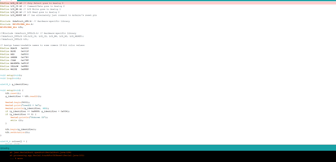

I bought this display Treedix 3.5 inch TFT LCD Display 320 x 480 Color Screen Module Compatible with Arduino UNO R3 Mega2560 https://a.co/d/1tQXCfq
It says that it is a ILI9486 driver but I can’t get to use the MCUFRIEND library and display any examples on the display. I do not know what I al doing wrong, I tried changing parameters on the code for the 480x320 but it still dors not work. I connected the display to an Arduino Leonardo.

I tried comparing the picture with the board I have on my desk but I cannot see well the J3 ports. Also, there are U2 and U3 on the picture and my board has U1 and U2 instead, I am not sure if there is a difference.
These are the pins that are connected and how I configured them to the Leonardo
LCD_RD A0
LCD_WR A1
LCD_RS A2
LCD_CS A3
LCD_RST A4
F_CS A5
I do not see an F_CS port on the picture of the link.
I do not know if I am doing something wrong.

Moroever, I plug in the shield with the corresponding PCB, for example, reset with reset, 3.3V with 3.3V, and so on?
I did that and used the Glue_Demo_480x230 and gave an error of sketch too big.

I tried the examples above and it takes a long time to upload.
Will it be recommendable to just get an Arduino Uno or Mega for faster upload and bigger sketches? Since, everytime I tried the examples that you mentioned it stays on the "Uploading"
This in an example of what it appears on the screen
I though I needed to change the analog pins according to the ones that are plugged in since there is no LCD_CD but I do have an LCD_RS
For faster and bigger sketches which Arduino board should I get? DUE, MEGA, or UNO?

But nothing appears on the shield and this is what it says on the Arduino IDE/code

I plugged the shield into the Leo like recommended in picture #6 of the amazon link. I tried the recommended examples mentioned above:
aspect.ino
diagnose_TFT_support.ino
graphictest_slim.ino
readpixel_kbv.ino
scroll.ino
testcard_kbv.ino
but the code does not uploads completely, it stays on "uploading" and the screen is just white.
This is an example of one of the examples recommended the code cor readpixel_kbv.ino:

and the code never uploads
The COM 10 is the Port for the Leonardo as it is stated on the tools>port tab

My apologies.
I ran readpixel_kbv. ino
I got a white screen
It gave me the error that avrdude: ser_open(): can't set com-state for ".\COM10” but ai made sure that the port was correct in the device manager and all the drivers were up to date.
I do not have another Arduino board but I can purchase the best bet for my shield, which it may be the Arduino Uno R3 correct?
readpixel_kbv.ino does NOT print to the Serial Terminal
diagnose_TFT_support.ino prints information to the Serial Terminal
LCD_ID_readreg.ino prints information to the Serial Terminal
I would buy a cheap Chinese UNO clone. I bet that you can buy a Uno clone from a local internet shop. You certainly can buy common items from UK Ebay shops.
Looking at Ebay.uk, Due clones seem to be very expensive !!
David.
