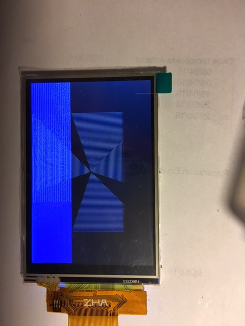

Hi, I'm excited, the screen work now, but don't work fine .
I modify the Begin in library again, with this code that I see in one web site, in this web speak from raspberry. But in the process of modify, I wrote wrong replace command, and I replaced all writedata register for writecommand :o

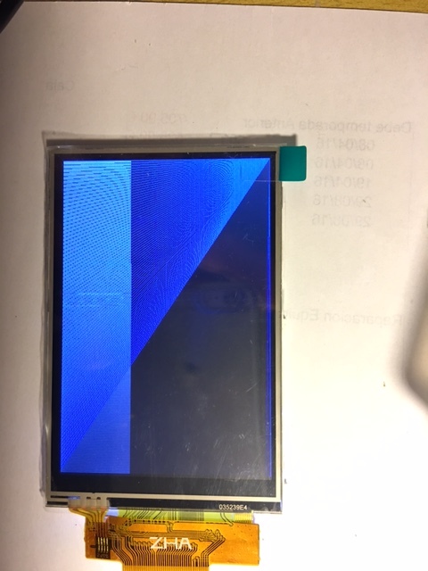

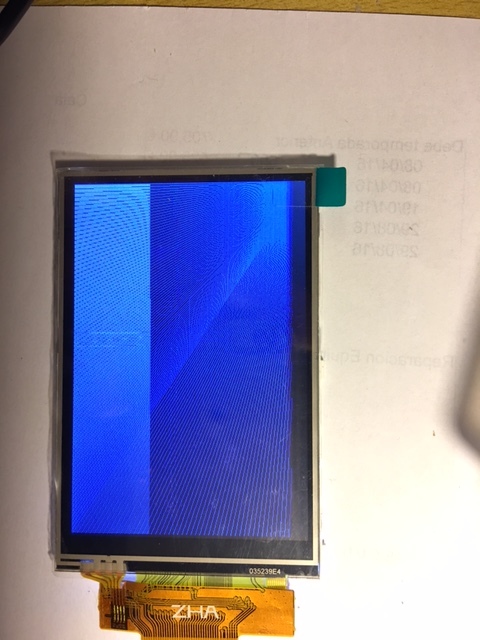

For example, in pixel format I obtain 0x66 , not 0x55.
The screen show results in screen, I attach photos of this.
I write again the sequence with good writedata, when correspond and the result are same of always, pixel format 0x55 but screen in gray forever :frowning:
Can you help me to write a good sequence for initialize this screen please?
Are you using 9-bit SPI or 8-bit + DC SPI ?
The good news is that you have managed to read the registers.
If you are getting GREYs, the controller might be expecting 18-bit colour rather than 16-bit.
Try writing 0x66 to Reg(0x3A)

I change the begin sequence again, because I don't like much that this use write register that don't are in the datasheet, for example 0xF2, 0xF1, 0xF8, 0xF9
I comeback to last begin sequence, posted in last post, with 0x55 on 0x3A, same result, gray screen, then, I change 0x66 to 0x3A, and the screen show image same the attached photos on last post, small area of screen draw, and in grayscale text.

And now, The screen show correctly all blue pixels, the other colors not show correctly.
It's obvious that I not know to apply the code correctly, I don't know how apply convertion from 16 to 18 bit depth properly.
Other thing, I use an 32-bit core microcontroller, I don't use an avr8bit. Can I send directly 32 bit data over spi bus?, if yes, in these case, I will can send 18 bit data in one step?.
Can you help me to implement correctly the transfer 18 bit to screen?, And I think that is much better create a table of color on 18 bit depth instead convert from 16 to 18.
I attach some photos with these modification
Thanks
