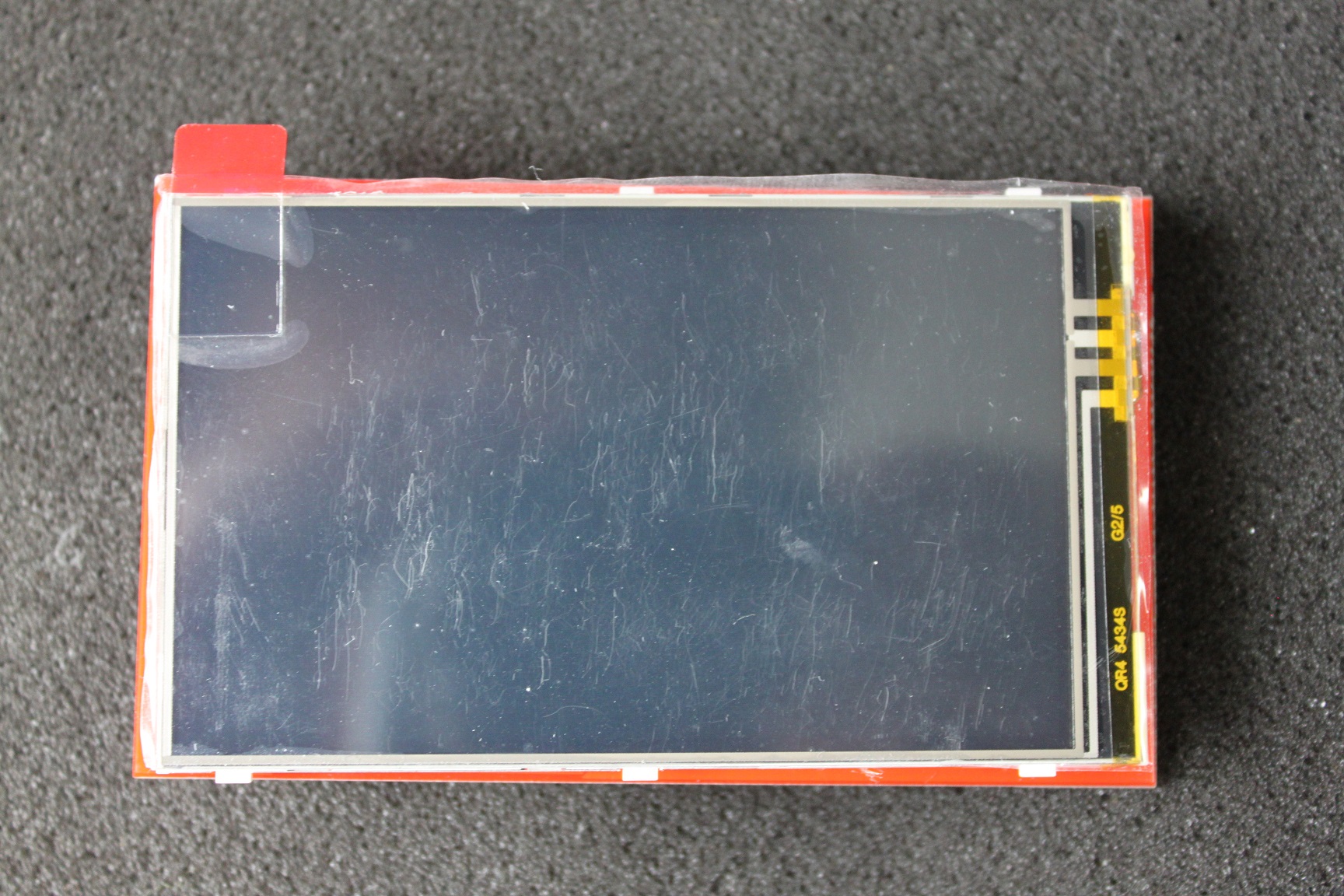

A picture of Shild I bought is attached.
I bought this Shild from AliExpress at $7.22.

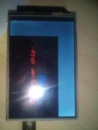

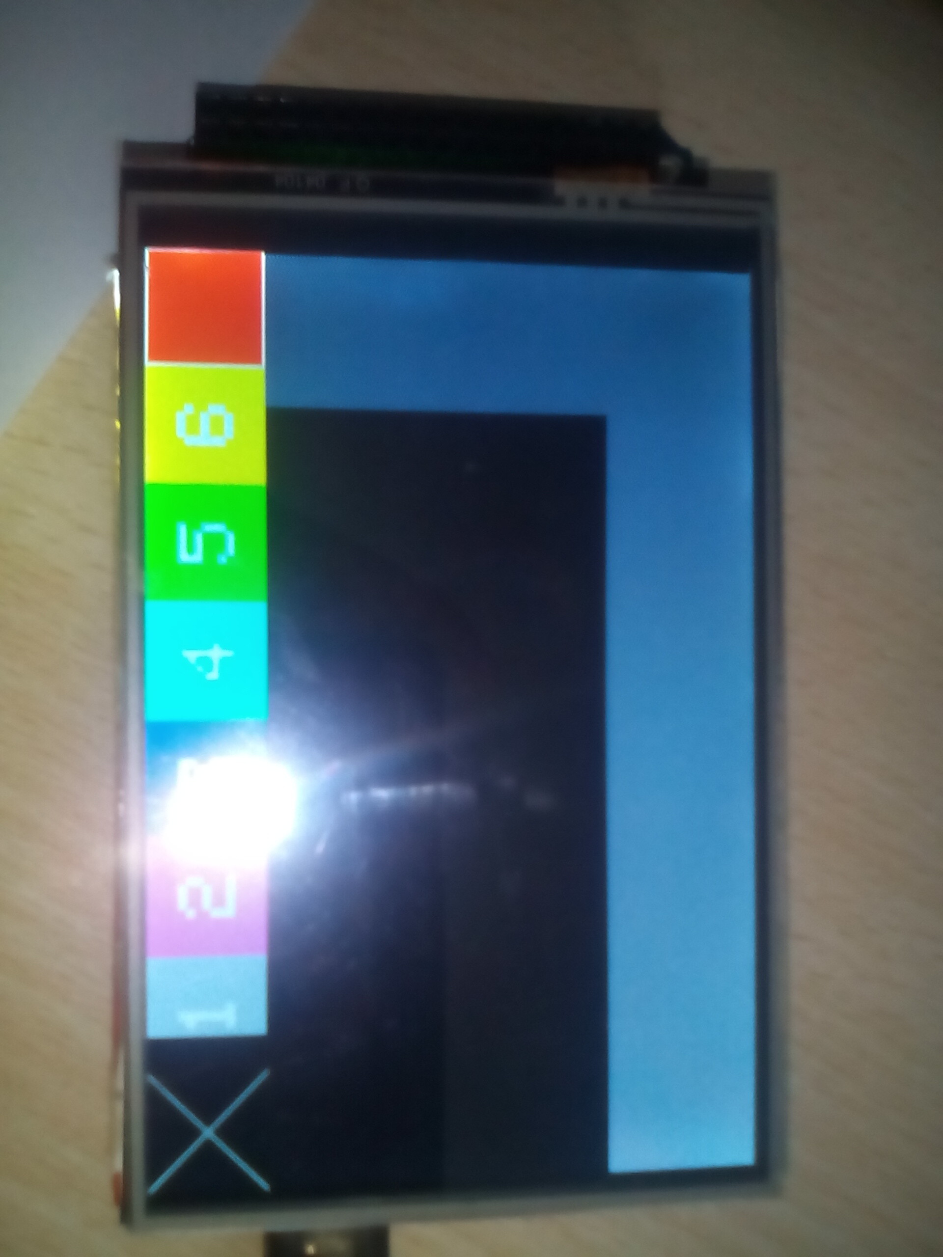

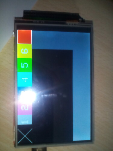

I put the library in 1.6.5 and tried tftpaint2_9327 on arduino mega 2560 (put directly in the board , not use pins 22..29)
It works but with some problems:
  • move slow
  • works on a little area from lcd , but it is defined like 9488 with 480X240 dimmensions.
  • touch not work
I attached some pics.
