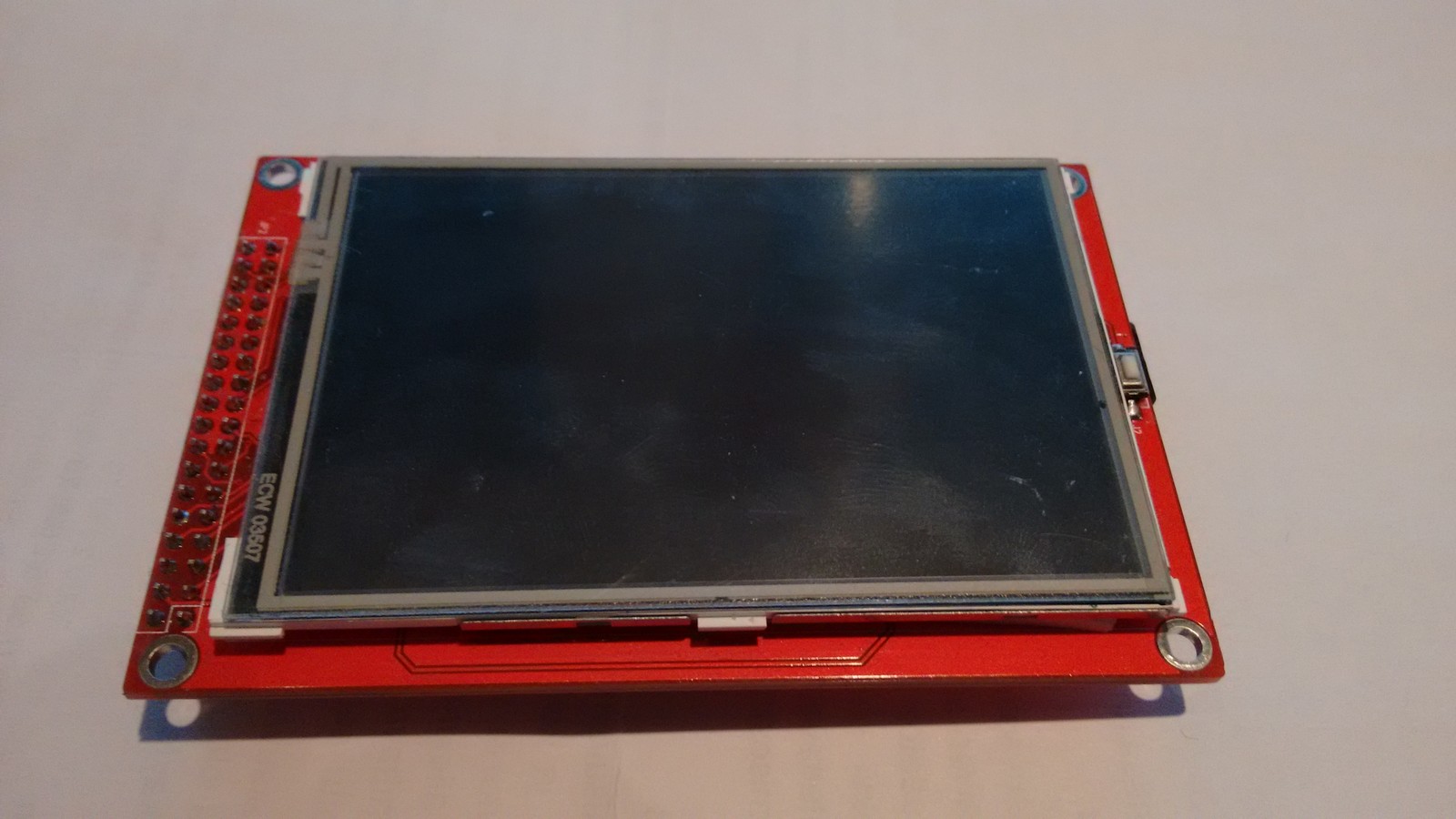

So i got 3,5" TFT touch Screen ILI9481 + SD card slot (MCU_friend.com) from aliexpress.
ILI9481
For arduino mega2560
Please see the pictures...

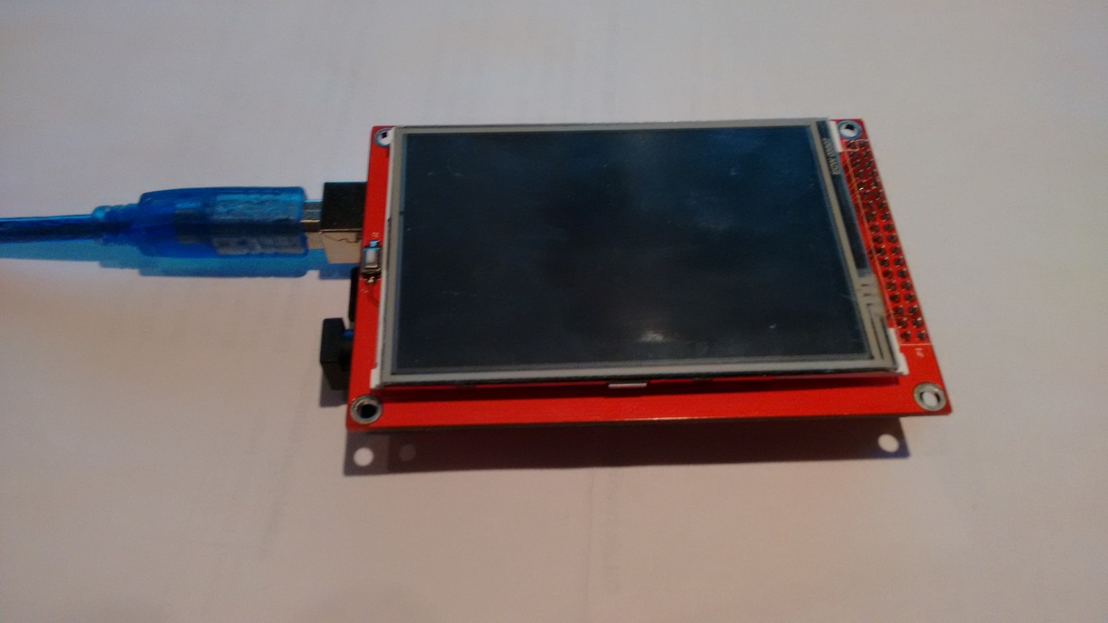

First impression was good, the screen is working with =)
UTFT myGLCD(ILI9481,38,39,40,41);
But thats it... Touch screen not working and sd card is not working.

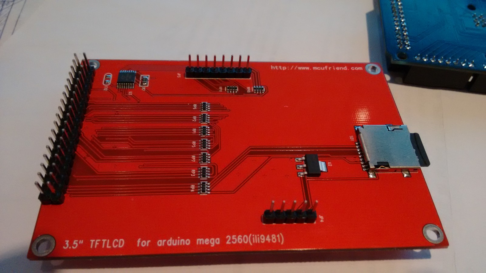

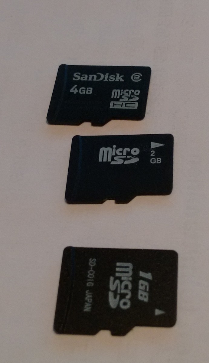

Lets start with sd card. I have tried three different sd card, please see the pictures.
And i have used the win7 basic format and the SDFormatter V4.0 to format the sd card..
I get something with SD.h example cardinfo.
what i use:
const int chipSelect = 53;
pinMode(53, OUTPUT);
Serial monitor says:
"Initializing SD card...
Card type: SD2
Could not find FAT16/FAT32 partition.
Make sure you've formatted the card"
With SdFAT library i dont get anything:
Only in serial monitor:
"SD initialization failed.
errorCode: 0x4, errorData: 0x2"
So what are the correct pins and setting for the sd card?
Anybody has a pin map for this shield?
Then the touch screen, it doesnt do nothing,
I have tried all compinations for it also
*I think the right setting should be:
UTouch myTouch(6,5,4,3,2);
So what are the correct pins and setting for touch screen?
An the pin map would be helpfull in future also... =)
Thank you for your support and understanding!!! =)

This is not a touch screen
Yes, it has a Touch controller.
Yes, it should work 100% fine. e.g. with UTouch library
The pcb says ILI9481. So it probably does contain an ILI9481. It might be ILI9486 or ILI9488.
The TFT should work 100%.
If it is an ILI9481, Rowboteer's new HX8357 / ILI9481 library will give you a far better performance than UTFT.
There is support for this and the other controllers with UTFT library.
No, the SD card will NEVER work (reliably).
The series resistors in the SD circuit are the wrong value.
It should really have a proper level-shifter chip for the SD.
David.
p.s. I will give you a medal if you get the SD working in a practical sketch.

Obviously you have ILI9481 and I have ILI9486.
You have verified that you have an ILI9481 and it is working ok.
I have a similar mcufriend MEGA2560 shield. And the Touch works fine on my shield.
The pcb traces are slightly different. But it seems to be a set of resistor packs instead of proper level-shifter chips.
Your photo shows a regular XP2046 or ADS7843 Touch Controller. These should work fine with the UTouch library.
David.

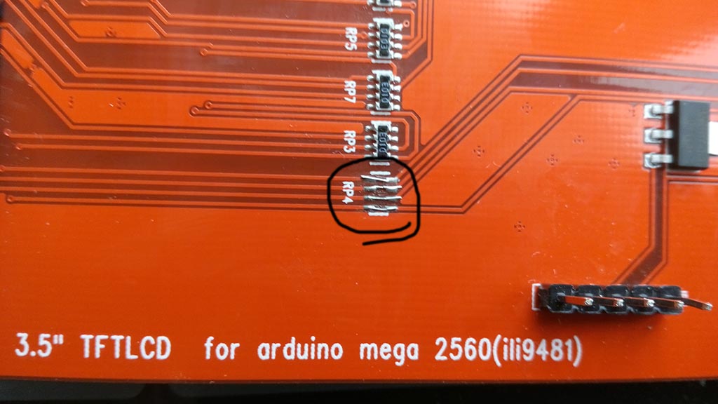

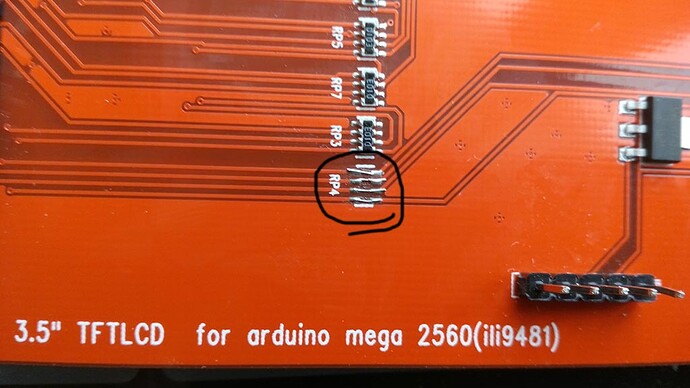

Hi!
SD card will work only without the resistor assembly (rp4).
