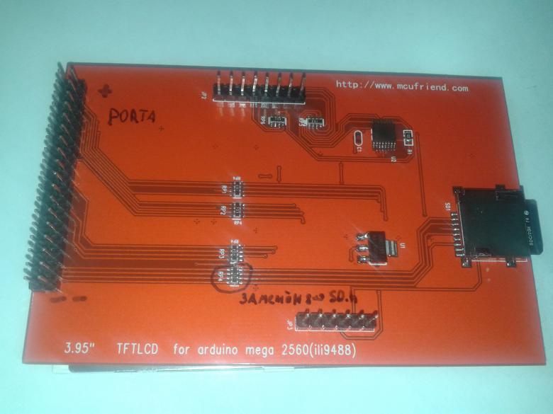

I recently bought a 3.95" TFTLCD for arduino Mega 2560 (ili9488) by MCUFriend. It comes with a XPT2046 for touch control.
Here is the picture.
upload picture without account
Apparently is a 8bit
I could make it work with the following libraries -> libraries СанСаныч от Slider ( UTFT,UTouch,tinyFat,UTFT_tinyFAT,Adafruit_TFTLCD,SD ) 3.95 TFT LCD for arduino mega 2560(ili9488) .rar — Yandex.Disk from this russian forum -> 3.5" TFT LCD красный меговский + mega 2560 R3 . РЕШЕНО ! + как решить другие ! | Аппаратная платформа Arduino
The issue is: I can't calibrate the display properly. Using the "UTouch_Calibration" sketch and replacing new calibration values in UTouchCD.h does not work properly. After calibration, using the UTouch_ButtonTest sketch doesn't work properly either (no matter what precision I use, from LOW to EXTREME). It doesn't makes any difference.

You clearly have an 8-bit interface. There are only 4 resistor-packs.
The photo in the Russian Forum link shows a 16-bit interface. There are 7 resistor-packs.
I have a pcb exactly the same as your Russian Forum link. My Shield contains a RM68140 controller.
My Touch Controller works ok.
I suggest that you compare the pcb traces around your XPT2046 Touch Controller chip. The pin wiring might be different.

This is the russian forum image:
If you observe, it's almost the same as mine.

What value is the Resistor-Pack that is connected to the microSD ?
Most are 10k and consequently the SD does not work reliably.
David.

About the resistor for the SD slot if you refer to "R1", yes, its a 10k resistor. Do I need to replace it with another value or I can not be using SD functionality? I tried tiny_FAT sketch and doesn't work. Thanks!
10k is far too high. You might find that it works with 1k resistor-pack. But I suspect you really need 0R.
Most microSD will "survive" the 5V SPI signals from a Mega2560. But I am not going to promise.
Of course, plug into a DUE and 0R will be safe. (you use software SPI because the DUE SPI pins are elsewhere)
0R is just soldered wire links. e.g. from stripped wire-wrap wire.
Please check the connectivity of RP1, RP2. It looks like it is wired to D22-D29.
Another Russian member has a photo of an 8-bit Shield that looks like the resistor-packs go to D30-D37.

Hi David, I tried SD Card with no success.
Tried at 10k(stock resistor), 1k and 0ohm. Not displaying anything. Just displays-> FILE NOT FOUND... PIC701.RAW, etc
Tried with a 4GB FAT16, and with a 1GB FAT16

I waned you to confirm that RP1, RP2 were connected to D22-D29. Your Russian photo says "PORTA" so it must use D22-D29.
I was more interested in the current thread from a Russian member whose photos look like PORTC (D30-D37)
I suggest that you test your microSD with the regular SD.h or SdFat.h examples.
There is no point in trying to use TFT images until you are happy that the SD is working reliably.

Well, tried SD.h in the example CardInfo, with chipSelect = 53 for arduino Mega (tested RP4 Wiring as you suggested, it's wired to pins 50,51,52,53). RP3 is attached to pins 38,39,40,41
Edit 1: You asked me to test wiring of RP1 AND RP2. Sorry, I'm testing now. Update this later.
Edit 2: Now tested RP1 AND RP2 they are wired to D22-D29
No success. Well, at least the sketch in Serial Monitor says
Initializing SD card...Wiring is correct and a card is present.
Card type: SDHC
Could not find FAT16/FAT32 partition.
Make sure you've formatted the card

I tried with both 1gb and 4gb microSD formatted to FAT16 or FAT32.
Always the same results.
And finally tried replacing the 0 ohm resistor by a simple wire (no resistance at all).
Should I try a 500 ohm or similar?
What can be the problem?
Thanks!!!!
0R equals zero Ohms equals wire link equals ...
Your MEGA2560 provides 5V signals.
0R means the microSD has to be 5V tolerant.
500R limits any current into the 3.3V microSD but not very significantly.
10k0 safely limits current but in the process ruins the signal. Hence SD.h might "work" occasionally. In practice the whole arrangement is UNRELIABLE.
The safest way to use a SD with a Mega is with a proper level shifting chip.
The Mcufriend Uno Shields just connect directly to the Uno 5V SPI which seems to work fine.
But you are relying on the microSD being 5V tolerant (which is not guaranteed)
David.

By the way, microSD card is still not working, and replacing R1 resistor for a 0R,wire or whatever stops touch capability. I forgot to mention that to David.
Cheers!
