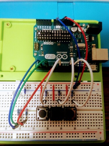

HI, Trying to make three independent momentary NO switches control each color in RGB LED. The script runs but the switches do not control the on/off state of the RGB. The RED diode is turn on without pressing any button. At this point I am lost!
Hi, Want to use independent swithes to control the on/off state of the RGB LED. When the script runs the swithes do not control the RGB. It runs and the RED LED comes on without pressing and switch.
REDcurrentButton = debounce(REDlastButton); //read debounced state
if (REDlastButton == LOW && REDcurrentButton == HIGH); //if it was pressed…
REDlastButton = REDcurrentButton; //toggle the LED value
REDledOn = !REDledOn;
digitalWrite(RLED,REDledOn);
// return REDlastButton; //return the current value
GREENcurrentButton = debounce(GREENlastButton); //read debounced state
if (GREENlastButton == LOW && GREENcurrentButton == HIGH); //if it was pressed…
GREENlastButton = GREENcurrentButton; //toggle the LED value
GREENledOn = !GREENledOn;
digitalWrite(GLED,GREENledOn);
// return GREENlastButton; //return the current value
BLUEcurrentButton = debounce(BLUElastButton); //read debounced state
if (BLUElastButton == LOW && BLUEcurrentButton == HIGH); //if it was pressed…
BLUElastButton = BLUEcurrentButton; //toggle the LED value
BLUEledOn = !BLUEledOn;
digitalWrite(BLED,BLUEledOn);
// return BLUElastButton; //return the current value

Your inputs are probably not floating, I see what looks like 10k ohm resistors in the photo you posted. On the other hand, you should respond to my post about the declaration, reply #3.
Thought Int = (13,12,8) should have been deleted. Also had a thought maybe my logic is reversed. Using a volt meter, measure 5v at each switch when not press and 0v when press?
