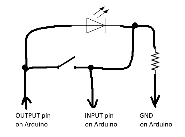

First off, thank you all for your various helpful replies. I understand most, though honestly I've done some breadboard experiments that don't 100% match up to some of the info I'm getting here, but I can go play with that later.
To answer ChrisTenone:
My project involves putting the switches (and some relevant LEDs, but that's not important here) in positions relatively remote from the brains. I'm using stereo jacks and cable to do the connections, so I've got three wires to work with. I'm using one to power an LED, one for GND (on that LED) and then I want one to go to the switch-reading-input.
I'm using 9v batteries because I have a bunch of 9v battery compartments and 9v batteries lying around.
That said, from what y'all have told me... I have a follow up question. Can I read across a switch that is connected in PARALLEL to another, not-a-switch piece of circuitry, so that I can pull the power for the switch and run the switch ground to the other thing?

bdmanevitz:
This will make the input read high all the time. If you take the wire from the led cathode to the input pin out then the input will only read high when the switch is closed. The led won't turn off then unless you make the output low at which point the input will read low.....
Both the output pin and the input pin measure voltage relative to chip gnd, those circuits are in the chip.
You could wire the led between the output pin and ground and wire the switch between the input pin and ground then pinMode the input as INPUT_PULLUP which supplies the input pin with weak 5V (through 20K to 50K resistance) that is safe to ground directly through the switch. Sure, switch open reads high and switch closed reads low but so - - what? You just code for what it is and you're okay, when the input is low you make the output high to light the led and when the input is high you make the output low to turn it off. That achieves an indirect connection between action of the switch and action of the led through software, demonstrates a form of abstraction. Don't say that in class unless you can say what abstraction is and just how it is demonstrated, of course.
Oooh, GoForSmoke, you beautiful son of a gun.
For your first suggestion (removing the line from the LED cathode to the input pin) - See (GoForSmoke idea 1), do I need a resistor between the switch and the input pin? I'm thinking no, since it's just reading the voltage off the output pin, so there's no risk of short. Unless I'm misunderstanding how shorting works.
On (GoForSmoke idea 2), I understand that the OPEN switch will read HIGH because of the PULLUP voltage, but won't the closing the switch still read HIGH because it'll be getting the voltage through the LED? (a la the pink dashed line?)

GFS #2 is the way to go.
I have done a more-extreme version with only 2 wires. It looks a bit like your diagrams in reply #6 but I use the output pin as an input for very short periods so the eye can't detect that the LED went off 100 times per second.
This was for a button with an LED in it so you could not see that the LED was shorted out while your thumb was on the button.
The LED current as you have drawn it will not occur, the LED current will flow to the gnd pin.
The input pin with pullup will be 5V with the switch open and at gnd when the switch is closed.
Because the switch is not part of the LED current circuit loop, it will not pass any LED current.

Sorry Tom but AVR inputs are through millions of ohms of impedance. A single non-INPUT_PULLUP read drains 1 microAmp of current. In that circuit, the input pin is also a 5V source.
This is in the datasheets.
I have used that 1 uA read current to drain a charged wire at over 50K reads/sec, counting the reads between HIGH and LOW as a form of very fast low-res ADC. That was for force-sensing piezo buttons.
GoForSmoke:
I think that what is I said?
The OP is worried about LED current flowing through the switch and keeping the input HIGH, which it won't because of the gnd connection.
Tom... :slight_smile:
You're right. The magenta dashed line arrow and way the words were got me turned around.
4 more karma and you are at 1284. The forum should add a P to that just because.
OKAY... Everybody rocks, but I gotta say GoForSmoke rocked this one the hardest. That layout solved my problems and answered most -- not all -- of my questions.
