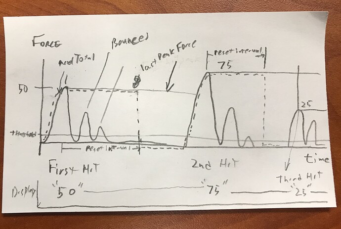

so heres the thing, i changed alpha to 0.1, its decent but when the mpu6050 bounces back, it also reads that value so i cant just increase the thresholdForce value. 0.2 on the other hand, it doesnt read the bounce back values, but should i trust 0.2 because the values are kinda big actually.
It is not clear what you want. What are "results" in terms of accelTotal, smoothForce, myForce, peakForce, or lastPeakForce? What is results 0.2 and what was the 261? What are their units?
Maybe draw some diagram of what you think is happening and identify what you want to happen.
Without any data, I'm imagining you want something like this:
Where the main line is accelTotal, dashed line is peakForce, and light line is lastPeakForce.
...and you hit something and the MPU6050's accelTotal force bounces around and you want to determine and display the lastPeakForce of a hit, ignore the bounces, and reset for the next hits. All the while displaying something like the lastPeakForce= "50" -> "75" -> "25" changes along the bottom timeline of my scribble.
If you want something different, or something like this but it isn't working as expected, you need to describe what you want better, and what is happening better.
Ok so after i took a look at your graph, and also my results, i realized one thing, that is the bounce normally 1/2 times the size of lastPeakForce, sometimes its smaller, and they never get bigger. So heres my idea, ill try to make thresholdForce = 1/2 lastPeakForce
What does your data look like? Can you draw a sketch of a graph of your data?
I intended thresholdForce to filter out the low-level non-hit noise with a low number and for the resetInterval / forceChecker.Time thing to mask a peak's subsequent bounces and then reset the peak detector to look for the next peak.
Without data I'd wild-guess threshold at 2g or 20m/s^2 to and if you are detecting bounces after forceChecker.Interval = 500ms, lengthen the interval to 1000ms or so.
Dynamically setting the threshold up above a bounce acceleration would work too, and might handle fast hits quicker than inhbiting peak detection past the peak time for a longer time window.
Without good data out here, it is hard to guess.
