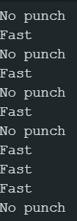

3 LED blinking randomly using millis got reversed for some reason
hmmmm what about the "No punch" case, you have any ideas about it?
When elapsedMilliseconds >= (LEDonTimer.Interval + LEDoffTimer.Interval) - some value you want, there was no punch.
  • LEDonTimer.Interval is 1 second
  • LEDoffTimer.Interval is 1 second
  • When elapsedMilliseconds = 2 seconds, there was no punch.
Example, not tested:
int oneTenthSecond = 100;  //you pick what you want to use
if(elapsedMilliseconds >= (LEDonTimer.Interval + LEDoffTimer.Interval) - oneTenthSecond)
   Serial.println( “There was no punch”);
i have an issue right here, after a pressed the button, no matter it is fast or slow, after printed out "you are fast only xyz ms", it printed "there was no punch". Same thing happened with slow.
Show us your attempt.
Oops, yesterday i forgot to paste it

  checkNoPunch();

void checkNoPunch(){
    Serial.println("There was no punch");
Review this version.

#define LEDoff                     LOW
#define PUSHED                     LOW    //+5V---[Internal 50k]---PIN---[switch]---GND
#define RELEASED                   HIGH
#define CLOSED                     LOW    //+5V---[Internal 50k]---PIN---[switch]---GND
#define OPEN                       HIGH

    //no punch ?
    if (elapsedMilliseconds >= LEDonTimer.Interval + LEDoffTimer.Interval - 100)
    stopWatchTimer.disableTIMER();

void checkSwitches()
  byte state;
  //================================================              button
  state = digitalRead(button);
  //was there a change in the switches state ?
  if (lastButtonSwitch != state)
    //update to this new state
    lastButtonSwitch = state;
    if (state == PUSHED)       //+5V---[Internal 50k]---PIN---[switch]---GND
      if (LEDonTimer.TimerFlag == ENABLED && stopWatchTimer.TimerFlag == ENABLED)
        //Start beep sequence
        frequency0 = frequency1;
        tone(speakerPin, frequency0, beepDuration);
        commonTimer.enableRestartTIMER();
        beepState = BEEP1;
        Serial.print("\nYou are Fast, only ");
        Serial.print(elapsedMilliseconds);
        Serial.println("ms");
      else if (LEDoffTimer.TimerFlag == ENABLED && stopWatchTimer.TimerFlag == ENABLED)
        frequency0 = frequency2;
        beepState = BEEP1;
        Serial.print("\nYou are Sloooow ");
} //END of   checkSwitches()
well you're right, i should make my own version
so i decided to figure out by my own, it is more simplified i think, heres how it works, i noticed that i can check the status of a button, every time the LEDs change to other, i check did a button was pressed or not, if yes, i pass, if no, i just simply say that there was no punch.
#define EXPIRED                    true

  if(statusButton == 0){
    Serial.println("No punch");
  else{
    statusButton = 0;
} //END of   randomly()

can i ask you this, well i dont really understand your buzzer code so i wanted to make it simple, then i can understand your code and use it fluently, just like the time that you explained how a timer works. Lets try to use one LED, every time it turns on, buzzer will beep, then when it turns off, buzzer will stop beeping. Thanks!

well i have a question right here, im trying to make a start button using one of 3 buttons that are use for testing are you fast or not, so heres my idea.
First, if you want to start testing, you need to punch to the middle, in my code, this button is button2.
Second, after you punched it, it will delay for 2 seconds, then start the testing program.
Finally, if you stop punching, (which is after 3 times "No punch" in the code), it will stop and go back to the first state which is waiting for you to punch the start button.
Here's my attempt, it didnt work well so can you take a look at it? Thanks
Oh and the method to do this is based on your 3 beeping buzzer

can you check it for me? it seems like at the start, i havent punched anything, but some how it printed out this everytime i turn on the serial monitor
